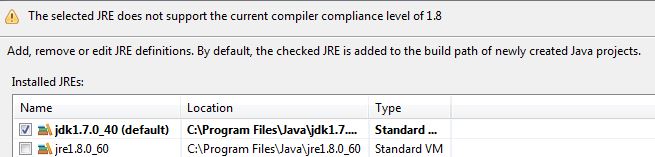

I make some adjustments to Java versions that Eclipse should use:
<b>Windows -> Preference -> Java</b>
I can see both
    Jdk1.7.0 which I use for development
    jre 1.8.0 which I use for runtime
I selected jdk1.7.0 in Eclipse for runtime over jre1.8.0 because I think using j2sdk at runtime gives me a better handle on the project.
index.php/fa/23505/0/
Eclipse reports: "The selected JRE does not support the current compiler compliance level of 1.8"
I hope I am not going to regret this!
Postscript"
OK, I regretted it, Help->Welcome threw error, does not display hiearchy-tree anymore.
Reset JRE back to 1.8.0 clears the error.

Re: j2sdk=1.8.0 BUT jre=1.7.0 Eclipse reports Compliance Issue [message #1710939 is a reply to message #1710907] Sun, 11 October 2015 09:03 Go to previous messageGo to next message
It sounds like you've chosen 1.8 for source compliance and for that a
1.8 JRE is needed.

Thx.
Fixed that up.
Steep learning curve, most enjoyable, cool stuff.
Sorry, actually the other way around: J2SDK 1.7.0 and JRE 1.8.0 Embarrassed
Now the ADT bundle Shocked
I hope ADT bundle won't complain about my Java settings. Confused
