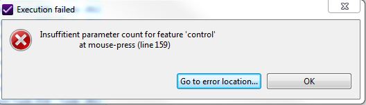

I need to run a right mouse button click on a table line to open a menu'.
This is the portion of code that select the line
get-items | foreach [val item] {
if [$item | get-property "values['Description']" -raw | matches [concat $prop1 $reference $prop3] ]
$item | select-item
The problem is when I use the mouse methods RCP TT is stopped.
Example:
$item | select-item
mouse-press 77 311 button3 -height 689 -width 413
return the following error:
index.php/fa/23502/0/

Re: Error when I try to emulate mouse right button click on the table [message #1710968 is a reply to message #1710823] Mon, 12 October 2015 01:33 Go to previous messageGo to next message
Hi Angelo,
Could you please attach a script which is recorded by RCPTT when you launch a menu on a table-cell?
I'm just wondering, why don't you use 'get-menu' command instead of mouse-click.
I've just tried on a tree and it works ok for me:
get-view "Test Explorer" | get-tree | get-items | foreach [val item] {
	if [$item | get-property caption -raw | eq P3] {
		$item | select-item | get-menu "New/Other..." | click
Kind regards,
Ulyana.
