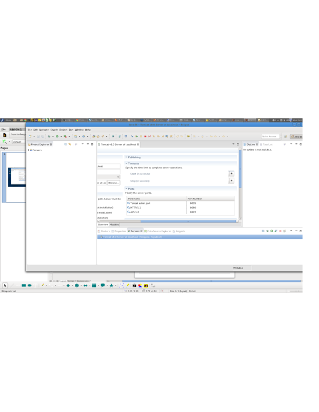

Having a problem in the Tomcat service setup on Mars and Luna. No issue with Kepler.
In the tomcat service configuration page, the Start Timeout and Stop Timeout edit boxes are not sized properly - I can only access the '+' component and cannot read the current value as shown in the attachment. BTW I see the same problem in the Publishing configuration.
Fedora 19, Cinnamon but also Fedora 22 Cinnamon and F22 Gnome 3 classic.
I'm sure this has been previously answered, but after several hours I've come up empty.
Appreciate any help or pointer.

I have also seen this on Linux Mint Cinnamon. All I can say for sure is
that the WTP Tomcat plug-ins haven't changed. My best guess is that
this is a problem between SWT and some of the new GTKs in use. I
haven't had any cycles to dig any further than that. If there is an
answer already out there, it may not be specific to WTP but Eclipse/SWT
in general. I assume any UI that used the same widget would suffer the
same problem.

Thanks for the reply Larry.
There are examples of this being used, for instance it's used in the System Settings for the Panel.
Even within Eclipse, it's used in a number of places including
Preferences->Tasks->Time Tracking
Preferences->Startup and Shutdown->Workspaces
As I said, I don't see this problem in Kepler, only with Luna and Mars so I think something changed somewhere.
I skipped over Luna because of this and I would continue to use Kepler but we're using Tomcat 8 now and Kepler only supports up to Tomcat 7.
