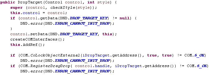

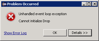

I am get an error : Unhandled event loop exception, Cannot initialize Drop
Also i tried same at debug mode and i realized the program throws an error when it trying to create on org.eclipse.swt.dnd.DropTarget:
public DropTarget(Control control, int style) {
if (control.getData(DND.DROP_TARGET_KEY) != null) {
		DND.error(DND.ERROR_CANNOT_INIT_DROP);
Any help would be so grateful.
