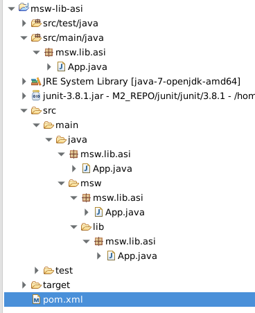

I have a simple maven project where eclipse shows the source folder multiple times.
See attached image:
index.php/fa/23453/0/

Did you notice that the icons on src/test/java and src/main/java differ from the icon on src? That's because you don't actually have src set as a source folder. Instead, the java folders under src/test and src/main are set as source folders.
Simple solution to the immediate problem: right-click on the src folder, then select Build Path -> Use as Source Folder.
That might be bad, though, if you have other things in src or src/test or src/main besides java source code. You may have to look at restructuring the project a bit.

Re: Mars shows source folder multiple times [message #1711433 is a reply to message #1710600] Thu, 15 October 2015 23:54 Go to previous messageGo to next message
here are for comparison both views, project explorer and package explorer:
Project Explorer:
index.php/fa/23558/0/
Package Explorer:
index.php/fa/23559/0/
The package explorer view seems ok. I normally do not use it, but I don't see any duplicate entries in the above screenshot.

Looks very much like https://bugs.eclipse.org/418344
Until that bug is fixed you may want to stick to the PackageExplorer ...
