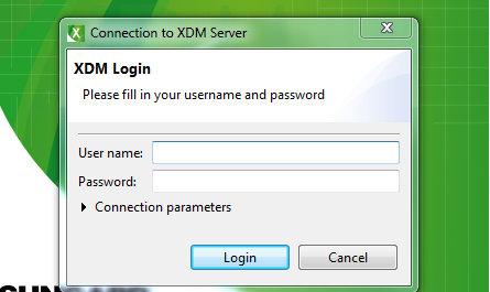

When I run RCPTT AUT after splash I need to insert user and password.
index.php/fa/23417/0/

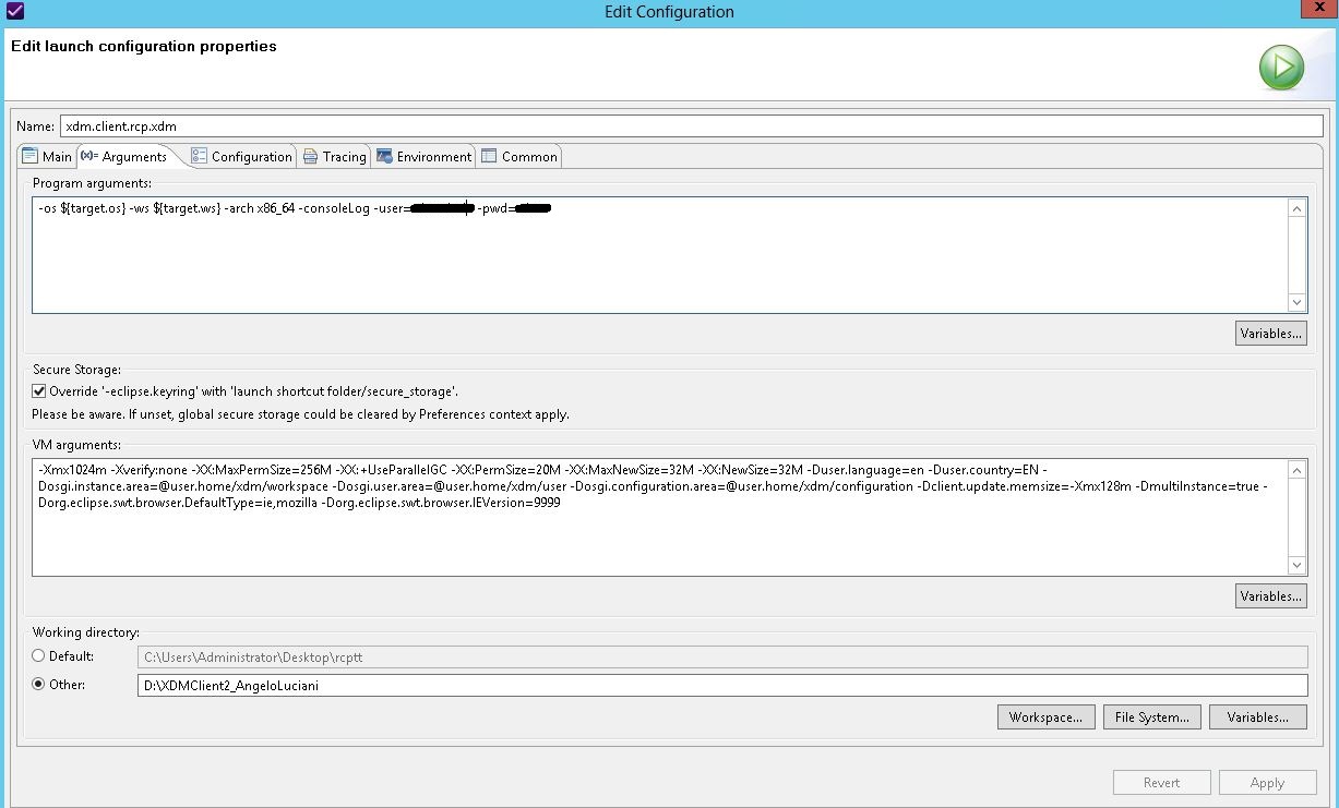

I already solved this problem from RCP IDE and I pass them as arguments.

I have to run the test cases using Maven because of CI with Jenkins.
Where I can insert the arguments using Maven ?

You should set it in <aut> in pom.xml:
<aut>
<args>
	<arg>-user=***</arg>
	<arg>-pwd=***</arg>
</args>
</aut>
Please try and let me know if it works fine for you.
Re: After AUT Splash Log In (How to pass arguments using Maven) [message #1709821 is a reply to message #1709816] Thu, 01 October 2015 07:42 Go to previous message
Olga you Rock ! It works ! Thank you
