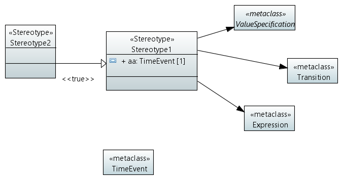

Re: UML TimeEvent in MetaModel [message #1710024 is a reply to message #1709840] Fri, 02 October 2015 13:55 Go to previous messageGo to next message
Thanks for answering..
I want to ask that the UML does not provide any unit for time, then what does actually means?
I have used "WaitTimeAction" in activity Diagram to manage the delay..But not sure how it works on profile level.
The way you said that we can extend a stereotype from "valuespecification" and "Expression" to create the unit for time. Let me show you a profile's portion built on your suggestion (See Attachment)..I have extended it from "Transition only because i need to apply it on transition.
Why are we doing this as ultimately we are typing by "TimeEvent"?
If the problem above can be resolved and we succesfully create "second" as unit of time, but the again it is not a built-in unit for time then how the validator will take that unit(second)?
Hope you understand the problem...
Any help in this regard would be appreciated..
Re: UML TimeEvent in MetaModel [message #1710729 is a reply to message #1710024] Thu, 08 October 2015 13:24 Go to previous message
I can only repeat what I said before: by the UML's not prescribing any
particular model of time units or other units of measure, this means
that it is up to the modeler to decide the meaning of time and other
measures. Certainly, Papyrus does not impose any additional time
semantics.
In the profile diagram, I don't see anything like what I had suggested.
* I do not see an enumeration of time units (cf.
java.util.concurrent.TimeUnit in the JDK)
* I do not see a stereotype with an attribute that would hold a time unit
* I do see a stereotype extending ValueSpecification, but it has an association
with the TimeEvent metaclass that doesn't seem useful
I thought the problem was that the values specified in TimeEvent and
similar metaclasses for measures of time didn't have, as defined in the
UML, units of measure. That's why I suggested a stereotype extending
ValueSpecification (which in UML provides the time measurement via a
TimeExpression element) to add an attribute specifying the unit of
measure. I have no other suggestion to offer.
