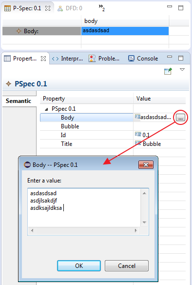

The button show up inside the "Properties" tab. Demonstrated in the Picture below.
index.php/fa/23381/0/
I'm facing two problems now.
I did not get the "up/down arrow" as described in the documentation.
The documentation also describes:
Under all systems, to finish the edition of a multi-line text, you need to use Ctrl+Return. Hitting Return will simply add a new line.
This functionalies only works if there is only one line "Feature".
Feature Name: body (work)
Feature Name: * (fail)
I hope you could help me with this issues too.
