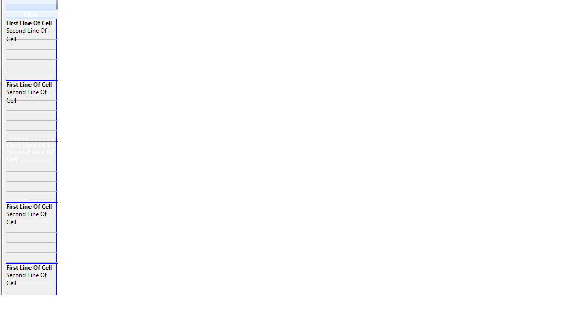

I have attached image showing above Problems
        configRegistry.registerConfigAttribute(CellConfigAttributes.CELL_PAINTER,
                new CustomLineBorderDecorator(new TextPainter(), new BorderStyle(1, GUIHelper.COLOR_BLUE,
                        LineStyleEnum.SOLID)),
                DisplayMode.NORMAL);
(First Column has Labels LEFT_LINE_BORDER_LABEL and TOP_LINE_BORDER_LABEL as well to get Borders)
                new CustomLineBorderDecorator(new RichTextCellPainter(true), new BorderStyle(1, GUIHelper.COLOR_BLUE,
                DisplayMode.NORMAL, firstColumn);
where do I find This " _424_NebulaRichTextIntegrationExample" ??

Re: Cell Text Formatting in Nattable [message #1709422 is a reply to message #1709412] Mon, 28 September 2015 07:05 Go to previous messageGo to next message
I suppose you are talking about the gray lines? You should wrap the RichTextCellPainter in a BackgroundPainter. The current implementation of TextCellPainter is itself a BackgroundPainter (which is IMHO not the best design regarding the painters and might be changed in the future).

Thank you very much... after wraping with BackgroundPainter everything is working fine.
