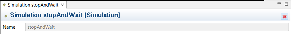

Red X:
Have a look at the attached image. It looks a little bit like it closes the view but it removes the model element and in my case the removing should not be possible for some model elements.

About the red cross: This is the standard Editor provided by ECP. If you
want to adapt this, you should implement your own editor.
To do that, have a look at the class MEEditor in
"org.eclipse.emf.ecp.editor.e3", it implements the editor itself and
internally it adds a "MEEditorPage", which adds the delete action.
After you have implemented your custom editor, you should implement an
ModelElementOpener to replace the existing one, see
http://eclipsesource.com/blogs/tutorials/tutorialshow-to-customize-the-emf-client-platform/#replaceeditor
As a template, have a look at the current ModelElementOpener:
"EditorModelElementOpener" in "org.eclipse.emf.ecp.explorereditorbridge"
