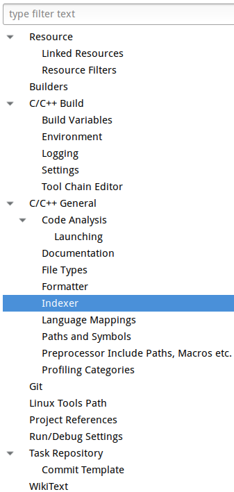

Re: Indexer disagrees with compiler [message #1708731 is a reply to message #1708729] Sat, 19 September 2015 11:27 Go to previous messageGo to next message
I have uploaded a screenshot to show that there is no discovery options. Could this be the problem?
Re: Indexer disagrees with compiler [message #1708733 is a reply to message #1708731] Sat, 19 September 2015 12:03 Go to previous messageGo to next message
Interesting. I doubt it. I don't use Discovery myself. It was just one of many possible solutions to your problem. Use of Discovery seems a deprecated feature. Perhaps your installation is more current than mine. There are a huge number of packages associated with CDT. I have no idea which one (or ones) control Discovery or the Indexer.
Odd that supplying explicit declarations and surrounding them with __CDT_PARSER__ failed to index them. If that didn't work then perhaps large sections of code are being ignored by the Indexer.
I have a running issue where the indexer refuses to recognize a member pulled from <random>. I don't know why but was able to circumvent it by telling CDT it's a macro. Something not always easy to do. The other option was to live with the annoying flagged error.
Good luck.
