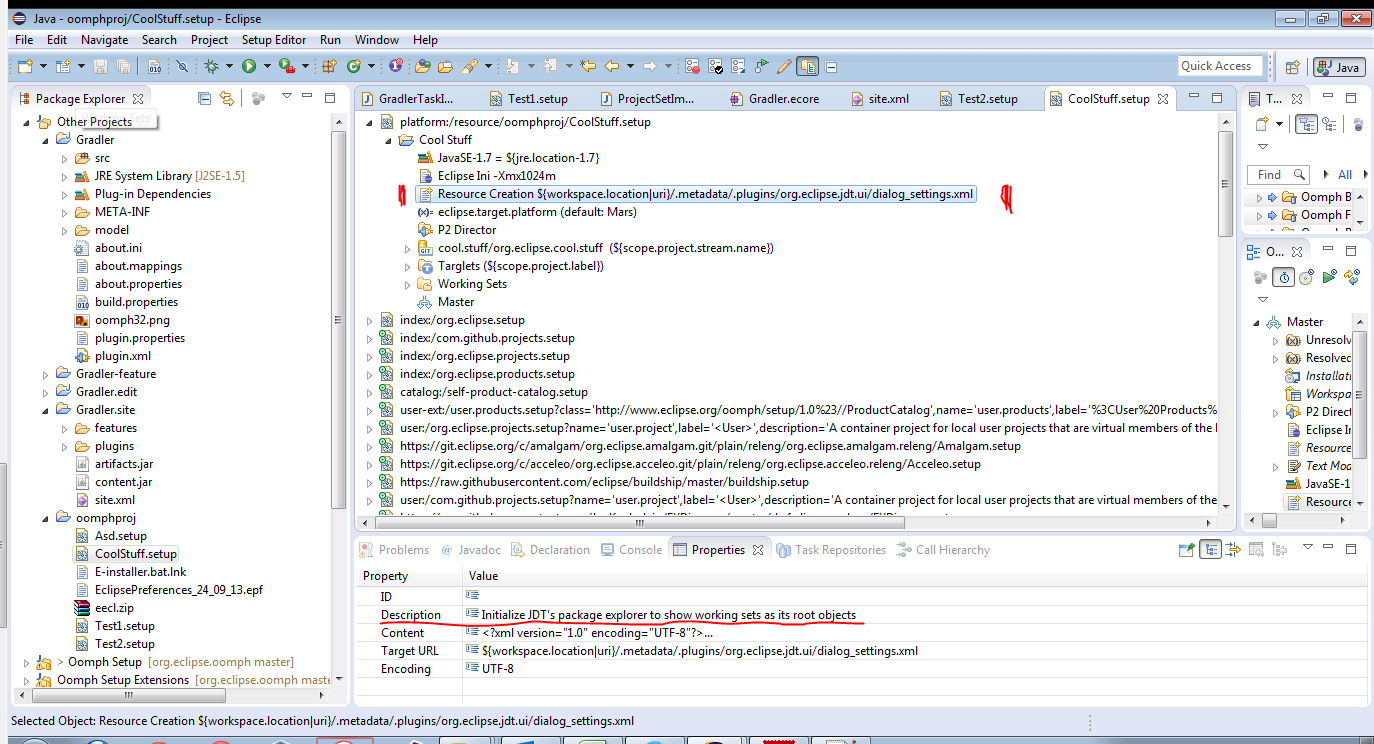

Re: Package Explorer: Top Level Elements [message #1708540 is a reply to message #1708537] Thu, 17 September 2015 07:02 Go to previous messageGo to next message
Hey Eike,
that is strange , when i create new project setup file then this task with the configuration above is created automatically... I don't touch it whatsoever...
When i delete the task then nothing changes, eclipse's default top level elements are still the working sets.
Cheers,
Maksim

Update:
Ahh, actually, when i delete the task, it makes Projects my top elements... However it is still strange that you get the task per default when you create a new oomph setup project.
Thank you for your help.
