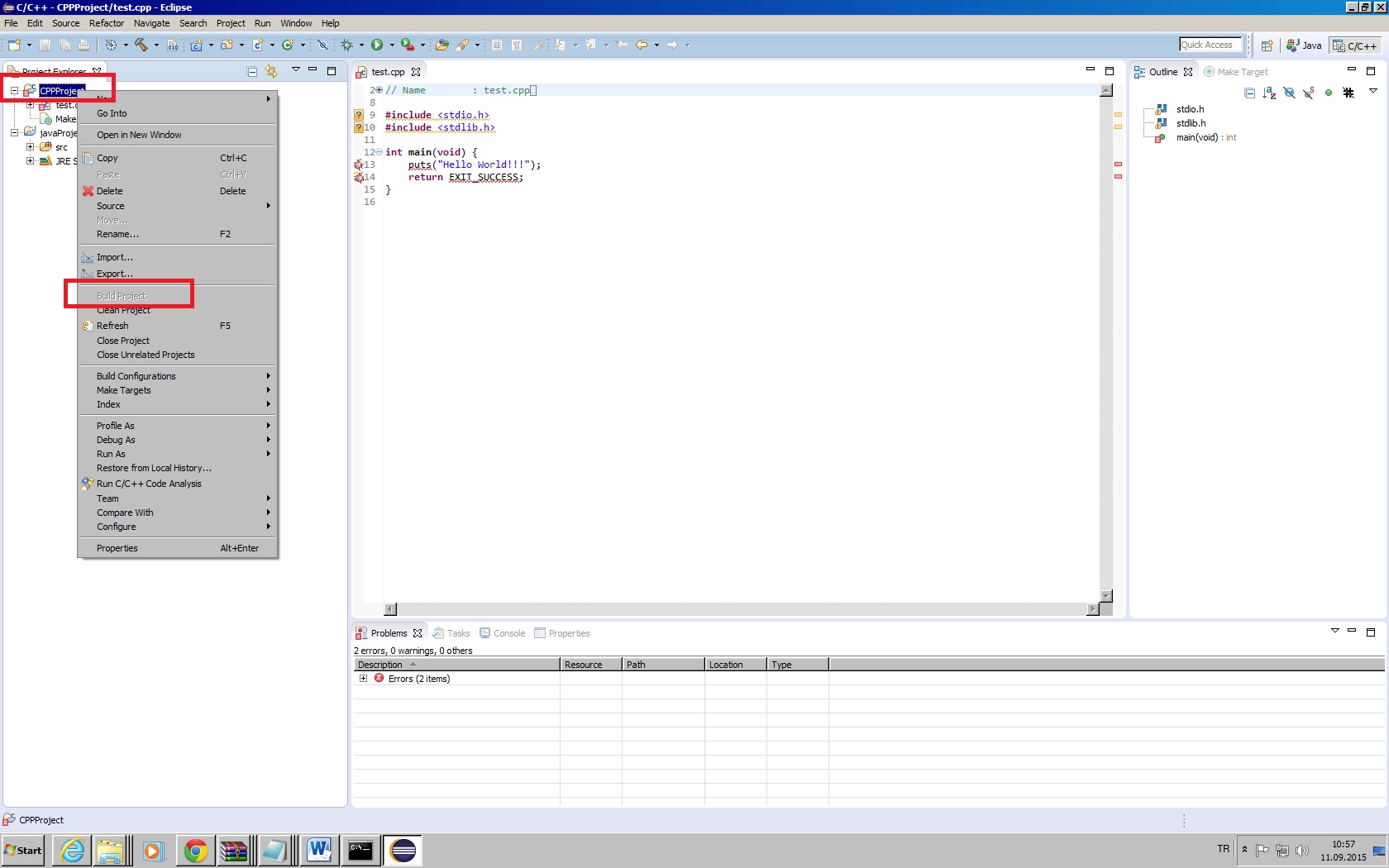

When I unselect a project by pressing control key and left button of mouse, it appears as unselected not blue higlighted. Now When it is unselected if you right click the c/c++ project then the Build Project is not enabled. This doesnt appear at the Java project ! But only at c/c++ project.

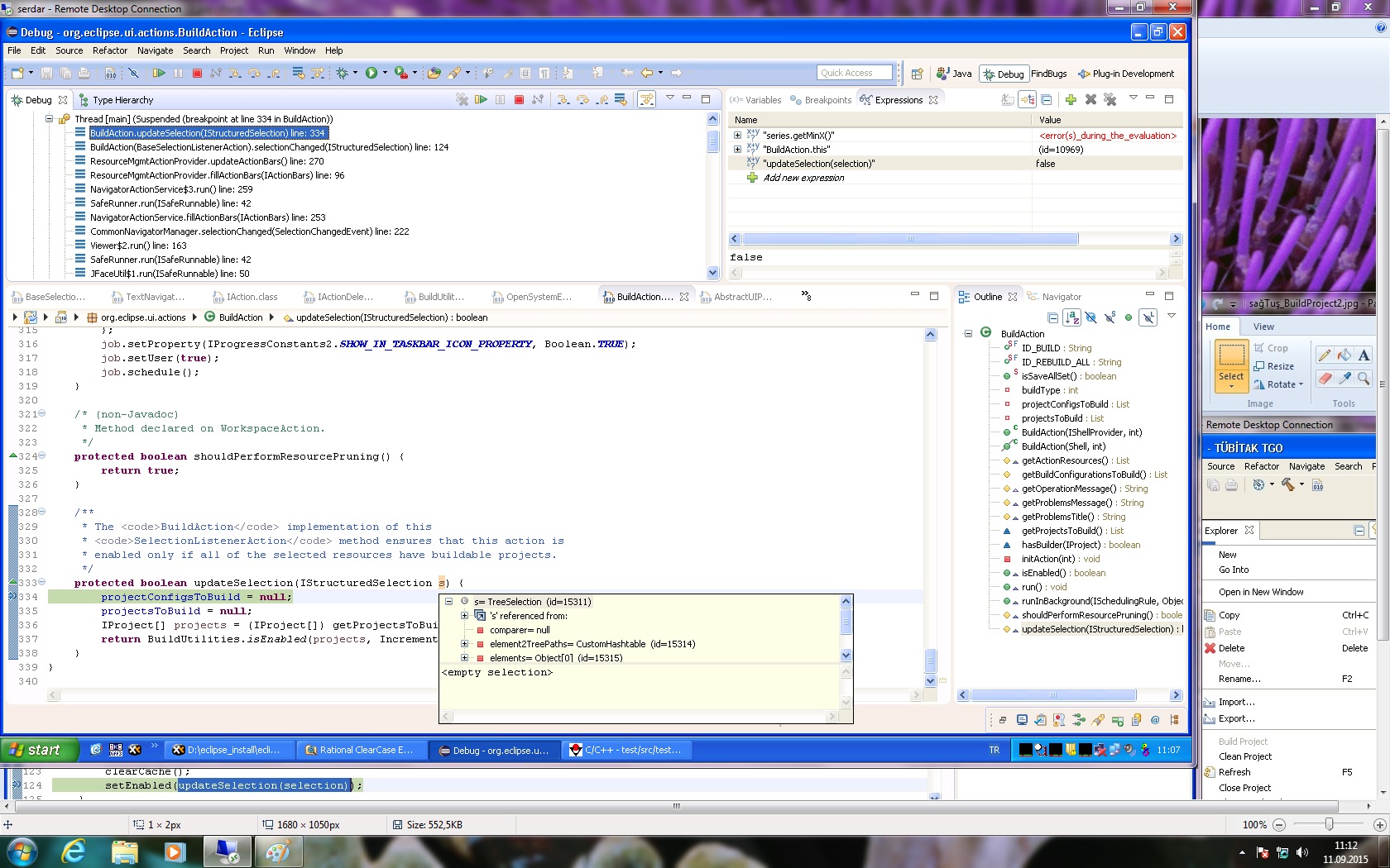

This happens in case when the selection happens to be "<empty selection>" then the setEnabled(updateSelection(selection)) expression is false . But the debuging also shows that the same code line can get the IStructeredSelection as project itself. So when It is evaluating for this button the IStructeredSelection is <empty selection> at for class BuildAction.isEnabled() method line 239.
Please look at the debugScreen screenshot for more information.
is this a bug ? How can we solve it ? Please dont hesitate to ask for more information.
Re: CPP (C) Project not selected right click shows Build Project not enabled. (is Bug ?) [message #1707990 is a reply to message #1707984] Fri, 11 September 2015 05:20 Go to previous messageGo to next message
Yeah. That's strange and probably a bug.
When I tried it, the project became selected with the right click but Build Project was disabled in the context menu.
This condition remains until another project is enabled. The condition is also cleared by selecting the same project with a left click.
