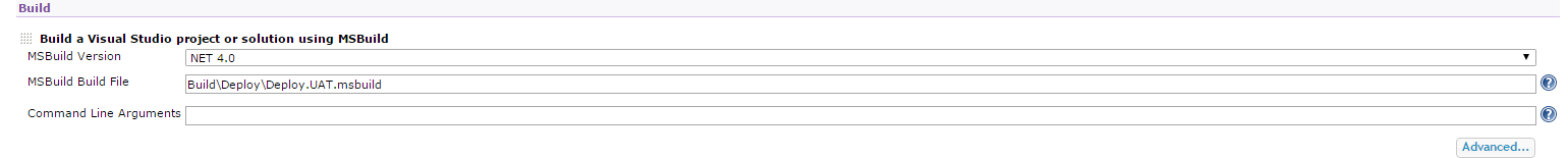

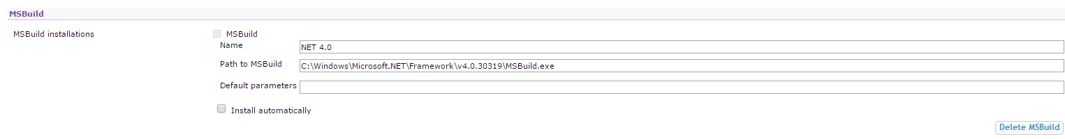

Re: Hudson 3.3.0 MsBuild plugin fails with NullPointerException [message #1707915 is a reply to message #1707914] Thu, 10 September 2015 09:57 Go to previous messageGo to next message
Here are screenshots of MsBuild configuration from "Configure System" and "Configure Job" screens.
