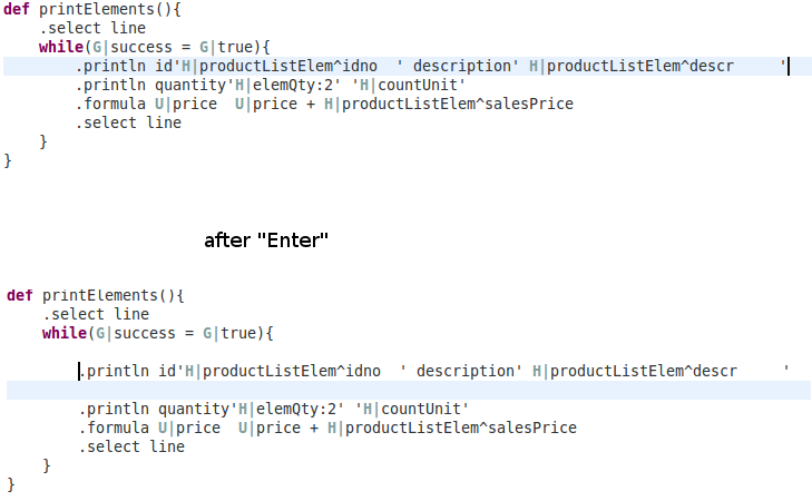

I'm experiencing a very strange rendering problem with xtext. When I go to the end of a line and make a new line, the editor doesn't get rendered right... For example the line disappears or it adds one new line before the line and one after.. I attached a screenshot example. I think something is wrong with the drawing in the editor, but I dont't understand what's the cause. I use the latest milestone of Xtext 2.9 and Mars. There are also no exceptions in the logs.
I've detached all kind of validators and hilighting calculators, but the problem still exists. I also regenerated multiple times the plugins from the grammar.
The problem occurs under Linux and Windows.

I'm still experiencing this problem. I also tested the code under Windows and Ubuntu and I have on both OS the same problem. Any ideas?
When I select the whole text area with Ctrl + A, then the rendering gets refreshed. but moving the cursor up and down, the rendering gets broken again.

No, it doesn't. Yesterday found the cause of the problem, but I'm not sure I understand why. A colleague of mine has implemented a PropertyTester, which causes the problem. When I remove the code it works normally. The funny thing is that we have two DSL languages: dsl1 and dsl2. The dsl2 extends dsl1. He implemented that in the first language and the problem occurs only in the second dsl. And it occurs after editing and saving the file. When I continue editing the editor gets broken.
