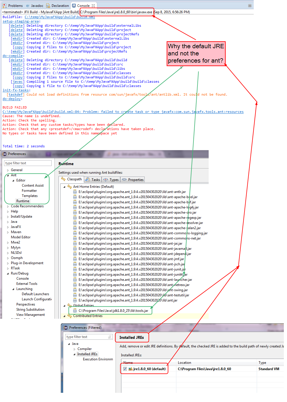

While updating this e(fx)clipse tutorial I am getting stuck. The current draft of the updated tutorial is here. The
"Generate ant build.xml and run" step produces the error seen in the embedded screen capture.
index.php/fa/23185/0/
I had to add a JAVA_HOME environment variable to my OS and set it to the JDK. Then I set the JDK in the eclipse.ini file too. But I am still having issues with ant.

The ant-launch is using the projects JRE System Library of the project
which is in your case only a JRE. The best solution is to teach Eclipse
about the JDK and remove the JRE.

Sorry, but I don't understand the answer.

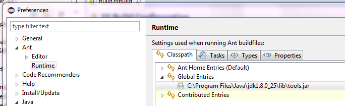

In my case the preference for ANT points to a JDK \...\jdk1.8.0_25\lib\tools.jar
Preferences -> Ant -> Runtime -> Global Entries. So why is the Java FX build using the JRE for the project and not using the preferences for ANT, when doing a build, as shown? What am I missing here?
index.php/fa/23207/0/
Why do I need to change anything with the JRE when the preferences for ANT point to the correct JDK?
Re: Why JRE and not ANT JDK settings? [message #1707872 is a reply to message #1707855] Thu, 10 September 2015 02:51 Go to previous messageGo to next message
It means, you are looking in the global preferences, not in the project properties. And you should configure a JDK to the Installed JREs and connect the appropriate Execution Environment.
