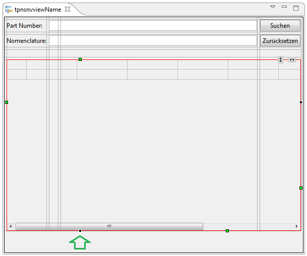

I have the following issues and kindly ask for help:

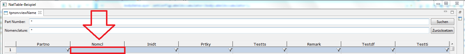

1.) The horizontalSpan is set to 4, but the columns don't fit to the whole space, as you can see in the attached picture "guiFilled.PNG".
2.) The verticalSpan changes its value automatically to -1 after I set it to 4. As you can see in the attached picture "guiDesign.PNG" I can influence the size by clicking and moving the frame, but during runtime, NatTable doesn't use the whole vertical space.

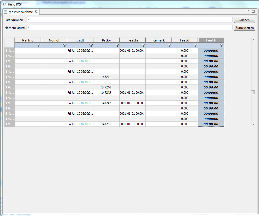

3.) As you can see in the attached picture "guiFilled.PNG" the row count numbers are shortened to 14..., i.e. the column does not grow.
How do you set the horizontalSpan? Are you using a SpanningDataLayer?
Again, how do you set the verticalSpan? I'm not sure if you use the framework for that. It looks like you are overriding some internal methods?
If you don't configure that it should do that, it won't do that. I assume you are using the DefaultRowHeaderDataLayer which sets a default width of 40 pixels. Either change the default width to something bigger or configure a TextPainter that is configured for automatic size calculation.
Actually, I have adapted the example classes, especially "FilterRowGridExample" and "FilterRowExampleGridLayer" which extends GridLayer. I think I should also mention the following three lines:
GridData gd_natTable = new GridData(SWT.FILL, SWT.FILL, false, false, 4, 1);

Regarding the spanning, yes it would have been useful to tell me that you are talking about SWT layouts and not NatTable spanning.
NatTable is using the whole space correctly according to the SWT layout. But your column widths are configured statically. By default every column has 100 pixels width, and that won't change simply by configuring the SWT layout. If you want some different behavior you need to specify what you expect. For example, you could tell the last column to use percentage sizing, so that column would increase/decrease according to the available space. You can also tell all columns to use percentage sizing, so all columns are calculated according to the available width. This can be done via DataLayer#setColumnPercentageSizing()

I still don't understand what you are trying to achieve. Is it about the height of the table? Maybe you have another control that takes the other space?
Maybe I see things totally wrong. If you look into the attached file, there is an arrow that shows to a point I can move in order to change the size of the frame. Instead of moving the frame, I would like to set a value for vertical spanning, e.g. 8, such that vertical spanning goes over 8 rows. The problem is that after setting this value, it automatically jumps to 1.
I don't know what you are showing me. Is this WindowBuilder? I never use this.
Yes, it's WindowsBuilder. What are you using?
I build my UIs programmatically to avoid such issues. I really don't have a clue what your layout issue could be.
OK, then I think it's the best if you could tell me how you set the vertical spanning in a org.eclipse.swt.layout.GridLayout, please?
I use the GridDataFactory. Maybe you should investigate some time in understanding SWT layouts.
http://www.eclipse.org/articles/article.php?file=Article-Understanding-Layouts/index.html
http://www.eclipse.org/articles/Article-Understanding-Layouts/Understanding-Layouts.htm
http://www.vogella.com/tutorials/SWT/article.html#layout
http://eclipsesource.com/blogs/2013/07/25/efficiently-dealing-with-swt-gridlayout-and-griddata/
http://www.vogella.com/tutorials/SWT/article.html#swtlayout_gridatafactory
Not sure what to post more. There are plenty of examples and explanations in the web.

I think I told you before not to use the Classic examples, as they are mostly hard to understand. Especially because the guys who implemented them created new classes in different packages that are not highly visible.
In short, why are you using the GlazedListsColumnHeaderLayerStack? It is a class implemented for such a classic example and it is not published as part of the installable NatTable parts. So using it will make things more difficult when it comes to things like automated builds and deployment.
In the Tutorial section of the examples you should find better examples. You simply need to create a custom column header layer stack that combines everything. And if you want to stick with the GlazedListsColumnHeaderLayerStack, copy it into your project and modify it to fit your needs.
You should also be careful with the layer stack creation. AFAIKS you are creating a body layer stack twice, which will lead to reference issues later on.
Re: Some issues with layout and refresh after list data changed [message #1708152 is a reply to message #1708146] Mon, 14 September 2015 05:52 Go to previous messageGo to next message
Due to time pressure I sticked with the GlazedListsColumnHeaderLayerStack and modified it.
At which place does this happen?
My new code is the following one, but I get errors (please see attached file):

Change
// Underlying data source
this.eventList = GlazedLists.eventList(new ArrayList<T>());
FilterList filterList = new FilterList(this.eventList);
this.rowObjectsGlazedList = GlazedLists.threadSafeList(filterList);
