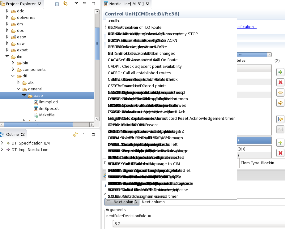

We have the following setup:
Eclipse Mars 4.5
GTK version 2.18.9
CentOS 6
With this configuration, the drop-down lists contain garbled text, probably when there are more elements than can be displayed without scrolling.
Please see attached image.
Can anyone please recommend a fix or work-around ?
Best regards
Vlad Gheorghe

Re: font display issues with mars/centos6 [message #1707317 is a reply to message #1707229] Thu, 03 September 2015 12:39 Go to previous messageGo to next message
I've seen oddities like that when an exception has occurred when building up the menu content
Does it happen on all popup menus, or just this particular menu?

Hi Brian,
It seems that no exception occurs in our case. This happens on all drop-down lists that
surpass a specific size (in this case more than 13 items).
Can you give us some hints regarding a potential fix for this?
Thank you !

Re: font display issues with mars/centos6 [message #1708118 is a reply to message #1707409] Sun, 13 September 2015 22:04 Go to previous messageGo to next message
Andreea,
Does this happen within the Eclipse IDE? If no, then there's something specific to your app.
In the case I described, it happened on most context menus. In trying to track the cause down, I discovered that the actual exception was caught and never actually logged: I stumbled across it by accident. Look at your code for dynamic menu builders (e.g., the org.eclipse.ui.menus <dynamic>).
If it happens within the IDE too, then try building a small standalone example that demonstrates the problem, ideally something using just pure SWT. You can build something pretty quickly in WindowBuilder.
Brian.

Hi Brian,
I do not manage to reproduce this in Eclipse IDE, so it it definitely an issue of the application.
However, i have discovered that this issue happens only with Combos that have the SWT.READ_ONLY constant set to TRUE.
It seems to be some conflict between this setting and the scrolling option of the Combo.
Therefore after applying SWT.NONE to the concerned combo, the scrolling becomes possible and the issue is solved.
Andreea

Re: font display issues with mars/centos6 [message #1710010 is a reply to message #1708669] Fri, 02 October 2015 11:37 Go to previous messageGo to next message
Hi Brian,
I have found the cause of our troubles. It seems that the default ViewerComparator that we use to sort the items makes them "overlap". Therefore i believe it is a JFace bug. I attatch the code. What do you think?
Andreea Pintea
