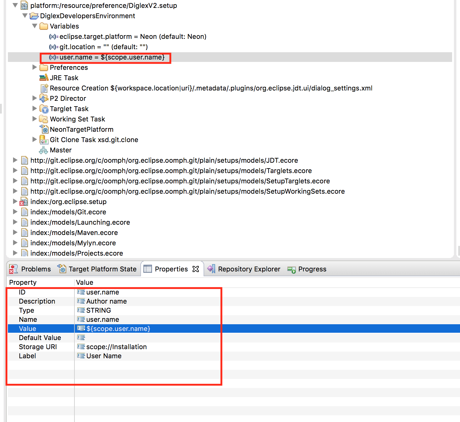

Re: How to add a new variable in the "Variables" wizard? [message #1748180 is a reply to message #1707193] Sun, 20 November 2016 13:11 Go to previous messageGo to next message
I have a same problem.
I try to create my custom variable and to display in the Variables Page of installer. But my attempt failed. Please see attached file.
What am I doing wrong?
Artem.
Re: How to add a new variable in the "Variables" wizard? [message #1748188 is a reply to message #1748180] Mon, 21 November 2016 01:18 Go to previous messageGo to next message
You've defined user.name to have the value ${scope.user.name} and scope.user.name is an induced variable that will have the value of the name property of the User scope. As such, even if the variable user.name is used in some task (as ${user.name}) it will already have value defined and will not be prompted. You could change your definition so that ${scope.user.name} is the default value of the variable. In this case (assuming ${user.name} is used in some task), the value will be prompted, but the field will have ${scope.user.name} as the initial value.

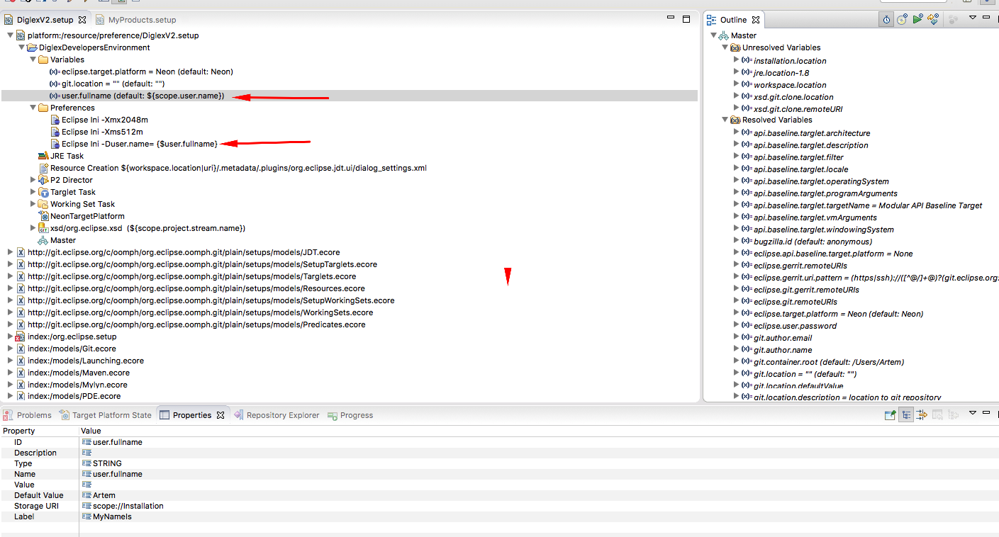

Re: How to add a new variable in the "Variables" wizard? [message #1749514 is a reply to message #1748188] Wed, 07 December 2016 11:32 Go to previous messageGo to next message
Hi Ed,
Thanks for help, but problem is not resolved.
See the screenshot in attached file.
It is a bug ? Or I'm wrong?
Artem
[Updated on: Wed, 07 December 2016 11:46] by Moderator
Re: How to add a new variable in the "Variables" wizard? [message #1749566 is a reply to message #1749514] Thu, 08 December 2016 03:52 Go to previous messageGo to next message
In your screen shot you have {$user.fullname}. No doubt you intended ${user.fullname}.
Re: How to add a new variable in the "Variables" wizard? [message #1749594 is a reply to message #1749566] Thu, 08 December 2016 08:20 Go to previous message
A lot of thanks, I inattentive.
My problem was solved.
