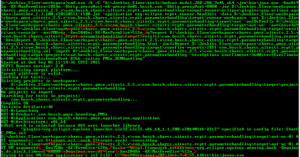

I wanted to modify the max size of the memory settings for the AUT VM.
Therefore I added the following settings in the pom file:
<aut>
<explicit>${aut-url}</explicit>
<vmArgs>
<vmArg>-Xmx2048m</vmArg>
<vmArg>-XX:MaxPermSize=512m</vmArg>
</vmArgs>
</aut>
But if I start the runner I see that the setting -Xmx is listed twice as AUT VM arguments. The first setting is wrong. Why is -Xmx listed twice and which of both values is used? How can I fix the problem?
See the following screenshot:
index.php/fa/23098/0/

most likely because it will use the default args for the runner and use the one you defined for the AUT. From my experience, it will use the last argument that one was defined. hope that helps.
you could also just set the arguments in the runner's vmArgs instead.

This is not an expected behaviour, I've created a bug about it in bugzilla.
I'll write here once it is fixed.
