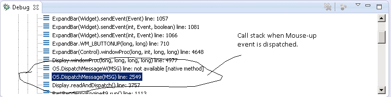

On debugging, I found that the mounse-up event is called because of OS.DispatchMessage.
PFA of call stack of Mouse-up event.
Is there a way to spin MSG?
