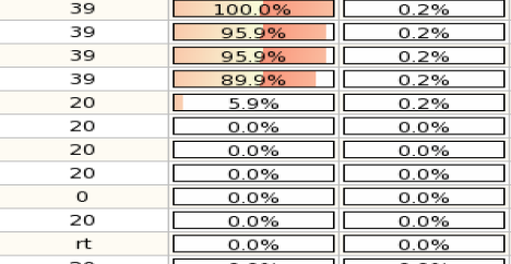

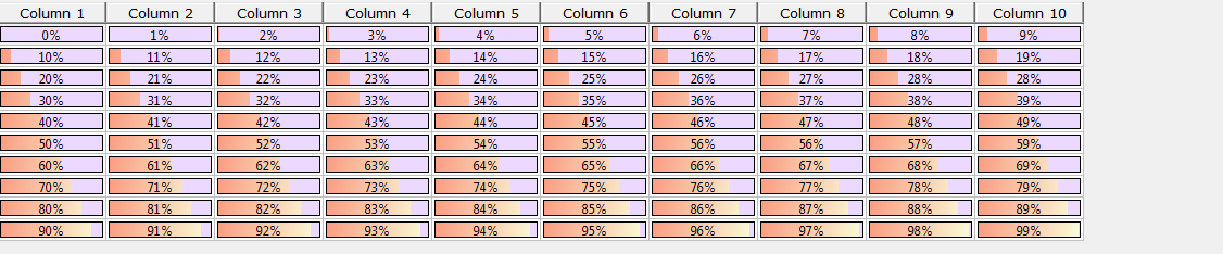

I have used the code of the "Using a custom cell painter" example from NatTable examples (under Classic Examples -> Styling) but the display of the color is incoherent and illogic. I have used the same code with the diference in the data provider, I used a Glazed list and I applied that style to two columns only. Further, I used a cusom PercentageDisplayConverter (doesn't differ from the one used in the example the only difference relies on the type of the values, I used double values). I tried to figure out the problem but I am really stuck, I did not found any plausible explantion to this behaviour. I am counting on your help to solve this problem. Thanks in advance.
Inès E.
PS : an attached photo of the example (how it is supposed to look like) and the second one is the output that I have got.
How it is supposed to look :
index.php/fa/23067/0/
My output :
index.php/fa/23066/0/
  • Attachment: myOutput.PNG
    (Size: 42.90KB, Downloaded 1441 times)
  • Attachment: example.PNG
    (Size: 32.50KB, Downloaded 1433 times)
[Updated on: Mon, 31 August 2015 09:02] by Moderator

Re: Custom cell painter example bugs [message #1706863 is a reply to message #1706857] Mon, 31 August 2015 10:12 Go to previous messageGo to next message
From what I see it looks like a bug in the PercentageBarDecorator. You could try to create the class locally and change the Pattern instance to use rectangle instead of the bounds variable for the definition of the Pattern coordinates?
I tested locally and could see the described rendering issue within a Grid. The modification I mentioned above fixed the issue for me. But it would be great to see if that is also true in your case.
If it is the case, please file a ticket so I can push the fix to our repository. It will then be part of the SNAPSHOT builds and released with 1.4.0

Re: Custom cell painter example bugs [message #1706877 is a reply to message #1706874] Mon, 31 August 2015 10:48 Go to previous messageGo to next message
The reason for the wrong colours seem to be a class issue, because the config attributes are defined in the painter. IMHO they shouldn't be there, but that is another issue. So changing the imports should solve the issue for you.
Do you have a grid composition? Because I had exactly the same rendering issue as shown in your screenshot, and it was caused by the missing offset that is added because of the row header in the grid. So my modification should solve the issue. At least if I understand the issue correctly.
Re: Custom cell painter example bugs [message #1706878 is a reply to message #1706877] Mon, 31 August 2015 11:07 Go to previous messageGo to next message
I think I understand why it did not work, When I made a debug to see why the colors are ignored (the one that I chose) and suprisingly, the debugger never entered in the class. So do you have any idea of why my class is ignored while I clearly speicified that I wanted to use it ?

 * Draws a rectangular bar in cell proportional to the value of the cell.
public class CustomPercentageBarDecartor extends CellPainterWrapper {
    public static final ConfigAttribute<Color> PERCENTAGE_BAR_COMPLETE_REGION_START_COLOR = new ConfigAttribute<Color>();
    public static final ConfigAttribute<Color> PERCENTAGE_BAR_COMPLETE_REGION_END_COLOR = new ConfigAttribute<Color>();
    public static final ConfigAttribute<Color> PERCENTAGE_BAR_INCOMPLETE_REGION_COLOR = new ConfigAttribute<Color>();
    private static final Color DEFAULT_COMPLETE_REGION_START_COLOR = GUIHelper
            .getColor(new RGB(187, 216, 254));
    private static final Color DEFAULT_COMPLETE_REGION_END_COLOR = GUIHelper
            .getColor(new RGB(255, 255, 255));
    public CustomPercentageBarDecartor(ICellPainter interiorPainter) {
        super(interiorPainter);
    public void paintCell(ILayerCell cell, GC gc, Rectangle rectangle,
            IConfigRegistry configRegistry) {
        Pattern originalBackgroundPattern = gc.getBackgroundPattern();
        double factor = Math.min(1.0,
                ((Double) cell.getDataValue()).doubleValue());
        factor = Math.max(0.0, factor);
        Rectangle bar = new Rectangle(rectangle.x, rectangle.y,
                (int) (rectangle.width * factor), rectangle.height);
       // Rectangle bounds = cell.getBounds();
        Color color1 = CellStyleUtil.getCellStyle(cell, configRegistry)
                .getAttributeValue(PERCENTAGE_BAR_COMPLETE_REGION_START_COLOR);
        Color color2 = CellStyleUtil.getCellStyle(cell, configRegistry)
                .getAttributeValue(PERCENTAGE_BAR_COMPLETE_REGION_END_COLOR);
        if (color1 == null)
            color1 = DEFAULT_COMPLETE_REGION_START_COLOR;
        if (color2 == null)
            color2 = DEFAULT_COMPLETE_REGION_END_COLOR;
        Pattern pattern = new Pattern(Display.getCurrent(), rectangle.x, rectangle.y,
        		rectangle.x + rectangle.width, rectangle.y + rectangle.height, color1,
                color2);
        gc.setBackgroundPattern(pattern);
        gc.fillRectangle(bar);
        gc.setBackgroundPattern(originalBackgroundPattern);
        pattern.dispose();
        Color incompleteRegionColor = CellStyleUtil.getCellStyle(cell,
                configRegistry).getAttributeValue(
                PERCENTAGE_BAR_INCOMPLETE_REGION_COLOR);
        if (incompleteRegionColor != null) {
            Region incompleteRegion = new Region();
            incompleteRegion.add(rectangle);
            incompleteRegion.subtract(bar);
            Color originalBackgroundColor = gc.getBackground();
            gc.setBackground(incompleteRegionColor);
            gc.fillRectangle(incompleteRegion.getBounds());
            gc.setBackground(originalBackgroundColor);
            incompleteRegion.dispose();
        super.paintCell(cell, gc, rectangle, configRegistry);
Re: Custom cell painter example bugs [message #1706880 is a reply to message #1706878] Mon, 31 August 2015 11:11 Go to previous messageGo to next message
Because you only created the new class, but did not create a new PercentageBarCellPainter that uses your custom decorator. Wink
There is no injection magic in NatTable ATM.
Re: Custom cell painter example bugs [message #1706883 is a reply to message #1706880] Mon, 31 August 2015 11:20 Go to previous messageGo to next message
Yes I figured it out when I was looking for the reason why it wasn't called Very Happy , It would be nice to have magic injection in the future though Razz
I am very happy to announce that it worked finally. Thanks a lot Sir, I could'nt have found the solution without your help.
