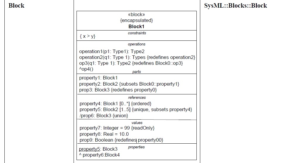

From the norm a block can contains the compartment properties.
index.php/fa/23294/0/
The associated image comes the norm and show that the compartment properties can shown property typed by a block, not only values.
This compartment can partivipant properties...
Compartment are propositions to display your elements. So you can hide or display choosen compartments.
  • Attachment: bloc.jpg
    (Size: 105.24KB, Downloaded 1376 times)

Page 51 of the formal-15-06-03.pdf document states the following:
SysML establishes four basic classifications of properties belonging to a SysML Block or ValueType. A property typed by a SysML Block that has composite aggregation is classified as a part property, except for the special case of a constraint property. Constraint properties are further defined in Clause 10, "Constraint Blocks." A port is another category of property, as further defined in Clause 9, "Ports and Flows." A property typed by a Block that does not have composite aggregation is classified as a reference property. A property typed by a SysML ValueType is classified as a value property, and always has composite aggregation. Part, reference, value, and constraint properties may be shown in block definition compartments with the labels "parts," "references," "values," and "constraints" respectively. Properties of any type may be shown in a "properties" compartment or in additional compartments with user-defined labels.
Perhaps the "properties" compartment referred to in the last sentence, is a kind of "junk room" where you park properties you don't want to bother classifying as either part, reference, value or constraint.
