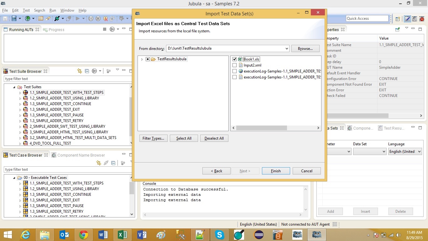

Hi Alex,
I'm trying to Import Excel files as Central Test Data Sets ( Files/Import/Test/Central Data Sets ). Yet, java.lang.NullPointException is through up. It is both for xls and for xml files. I work on Jubula 7.2 version, with win 8, on descktop machine. Test case that I'm using is from Samples ( Adder ) and it works successfully. Error appears only when I import input data.
Thanks in advance,
Elenka

Re: import data with Excel [message #1706938 is a reply to message #1706730] Tue, 01 September 2015 02:03 Go to previous messageGo to next message
Hi Elenka,
what exactly is happening? Please add more Details like e.g. log files etc. Did you make sure you are using the correct Excel sheet (i.e. including the correct Parameters written in the correct way)?
Oliver
