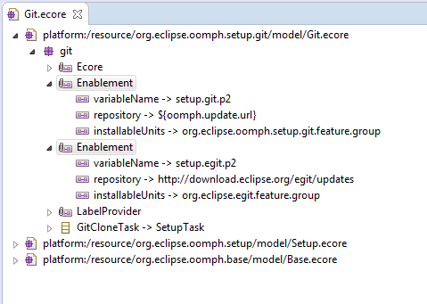

Where do i find the  enablement annotation on the EClass ? </blockquote>
Have a look at one of our extension models, e.g., Git.ecore:<br>
<br>
<img src="https://www.eclipse.org/forums/index.php?t=getfile&amp;id=23193" alt=""><br>
<br>
<blockquote cite="mid:msp15l$a4d$1@xxxxxxxxe.org" type="cite">How
do I set it ?
<br>
</blockquote>
You can copy/adjust from any of our extension models.<br>
<br>

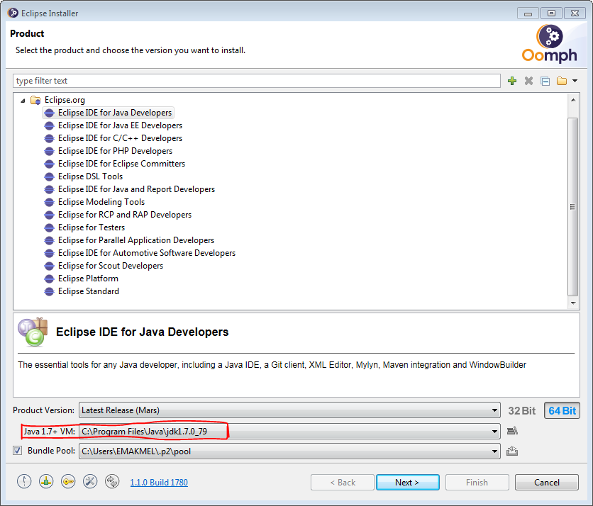

All my projects are created using java-7. Now, in order to start oomph i need the java 8. Thus, i change my path to java8 and start oomph.

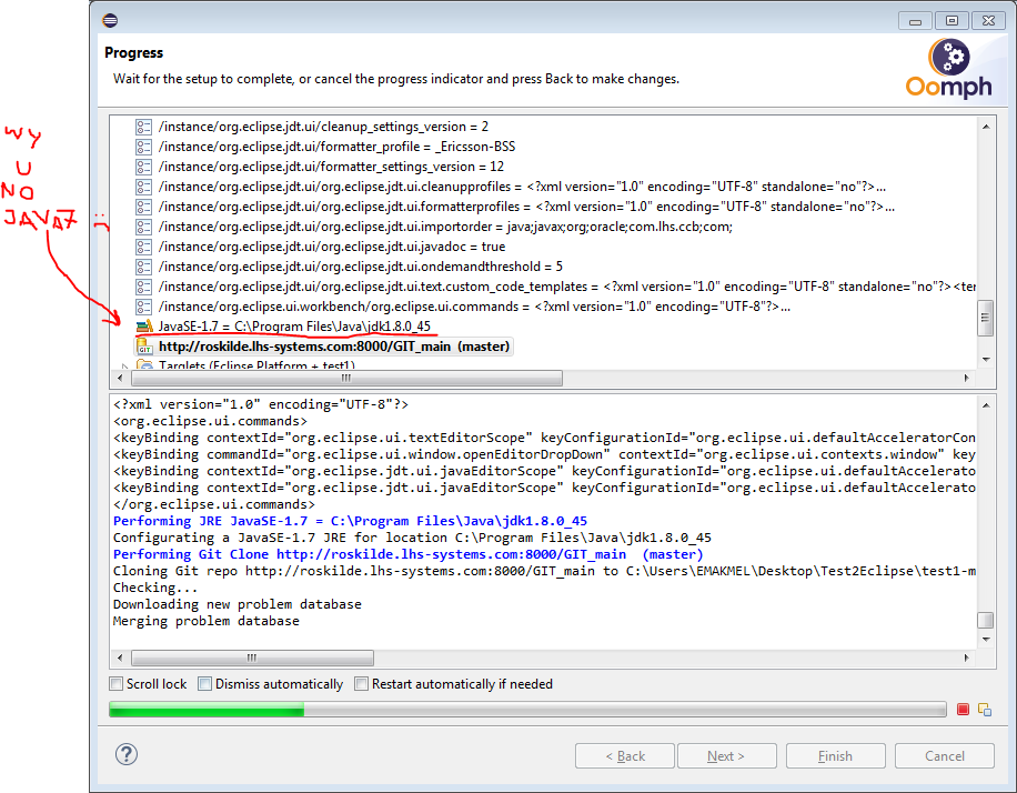

Since i want my eclipse to run on java7 , i chose it in the very first menu of oomph. (First screenshot)
After oomph installs the new it starts it, so far so good.
But then , what i see is , that the new eclipse actually uses java8 (Second screenshot)
Is it a bug, or am i doing something wrong?

Yes, the Platform decided to make use of Java 8 in Neon, for example in JFace and the help system.
Yes, the installer knows about the minimum Java requirement of the different products and product versions, e.g., Java 7
for Mars, Java 8 for Neon.
Well, that's not the JRE to be used for the installed IDE, it's the JRE used for Java development in that workspace. And
you must have picked that at some point. It's probably stored in your user.setup and you can change it there at any time
and reperform the respective JRETask to have your workspace adjusted.

thank you again for your reply, i found that the JRE path variable was hidden in the installation menu Smile
