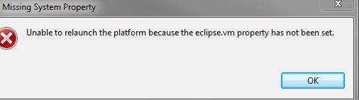

I've attached the error message: "Missing System Property - Unable to relaunch the platform because the eclipse.vm property has not been set."
My system's JAVA_HOME is 1.7 due to many applications that require it, but our project is 1.8.
I've applied the argument:
-autVM "C:\dev\Java80\sdk\jre"
which results in the application working correctly. However, when I attempt to restart AUT in the middle of a test, I get the error.
In addition, to try to fix it, I tried:
-autVMArgs -vm [path\to\javaw.exe]
and that did not remedy the problem (I may have not been inputting it correctly). The application works fine when using normally, and fine when running it from RCPTT in the normal GUI environment. I tried to google the issue, but it hasn't helped very much.

REM !!! Replace the value below with the path to the directory there
REM application under test (AUT) is located.
SET APP="C:\Program Files\[HIDDEN]\platform\eclipse"
SET AUT=%APP%\eclipse.exe
SET RUNNER="C:\Users\[HIDDEN]\Desktop\rcptt.runner-2.0.0\eclipse"
SET PROJECT="C:\dev\Designer_dev64\RTC workspace\qe.automation\qe.rcptt.designer"
SET VM=%APP%\jre
REM Path to directory with test results
SET RESULTS=%PROJECT%\..\results
REM Remove results dir if present
IF NOT EXIST %RESULTS% GOTO NORESULTS
RMDIR /S /Q %RESULTS%
:NORESULTS
md %RESULTS%
java -jar %RUNNER%/plugins/org.eclipse.equinox.launcher_1.3.100.v20150511-1540.jar ^
-application org.eclipse.rcptt.runner.headless ^
-data %RESULTS%/runner-workspace/ ^
-aut %AUT% ^
-autWsPrefix %RESULTS%/aut-workspace ^
-autConsolePrefix %RESULTS%/aut-output ^
-htmlReport %RESULTS%/report.html ^
-junitReport %RESULTS%/report.xml ^
-import %PROJECT% ^
-autVM %VM% ^
-testOptions "passedTestDetails=true" ^
-suites RunDevTestSuites
[Updated on: Thu, 27 August 2015 12:14] by Moderator
Re: Error Restarting AUT from Test Runner [message #1706936 is a reply to message #1706553] Tue, 01 September 2015 01:18 Go to previous messageGo to next message
Hi Lucas,
There should be
SET VM=%APP%\jre\bin\java instead of %APP%\jre.
Could you please fix and try again?
Why don't you use maven to start your tests headless? RCPTT has it's own maven plugin, please see the details here: https://www.eclipse.org/rcptt/documentation/userguide/maven/
Kind regards,
Ulyana.
Re: Error Restarting AUT from Test Runner [message #1707037 is a reply to message #1706936] Tue, 01 September 2015 12:38 Go to previous messageGo to next message
It didn't help. I think the root cause is from the switch workspaces in the test. I've done more searching on that and it seems like it can be an issue when executing eclipse in certain ways. I'll try to find ways around this in our tests because it looks like it will be a pain.
Re: Error Restarting AUT from Test Runner [message #1811313 is a reply to message #1706440] Fri, 30 August 2019 09:40 Go to previous message
