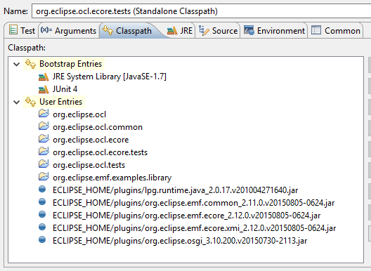

You have to work quite hard to keep a standalone classpath under
control. You want nearly nothing, so start with nothing and add
libraries one at a time to resolve CNFEs.
Attached is the launch configuration that demonstrates that the
Ecore-based OCL JUnit tests can be run standalone.
No org.eclipse.core.runtime.
It only needs org.eclipse.osgi and that probably only for NLS.bind().
Ed Willink

<div class="moz-cite-prefix">Hi<br>
<br>
Missing picture:<br>
<br>
<img src="https://www.eclipse.org/forums/index.php?t=getfile&amp;id=23117" alt=""><br>
<br>

  • Attachment: dfecigdd.png
    (Size: 15.81KB, Downloaded 148 times)
