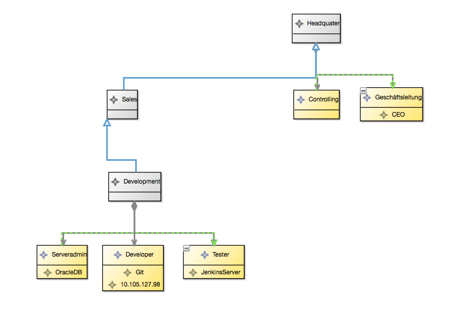

In the Edge Style properties you can specify a specific source and
target mapping for which the edge will be centered.
However the OrderedTreeLayout will arrange all edges without necessary
keeping their existing location (if it's what you would like to do for
blue edges). The OrderedTreeLayout can also be restricted to a specific
set of nodes or children (by using the Children expression) but in your
case you probably want to layout the Grey containers in the same way
than yellow ones.
Florian
On 08/18/2015 03:40 PM, Bernhard Edler wrote:
> I have a diagram based on an OrderedTreeLayout.
> The »arrange all« - behaviour works fine (or at least as expected ^^), but I#m having troubles with the positioning of my edges.
> Is there a way to enforce the »arrange all« - behaviour to draw the green dashed lines in my example below my yellow containers (source and target centered at the bottom edge) while leaving the grey and blue edges the way they are?
> regards,
> Bernhard
