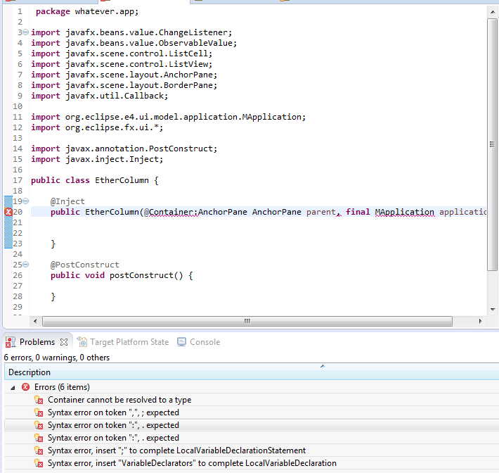

I did a search on this forum but could not find an example of the syntax to override the default "Container:AnchorPane " using injection. If I understand correctly, as per this (https://wiki.eclipse.org/Efxclipse/Runtime/e4) link, it is possible.
What imports, if any, are needed and how do I tell DI to override the default "BorderPane" with the "AnchorPane"?
I tried the following but they did not work.
public EtherColumn(@Container:AnchorPane) parent, final MApplication application) {
and this ....
public EtherColumn(@Container(AnchorPane) parent, final MApplication application) {

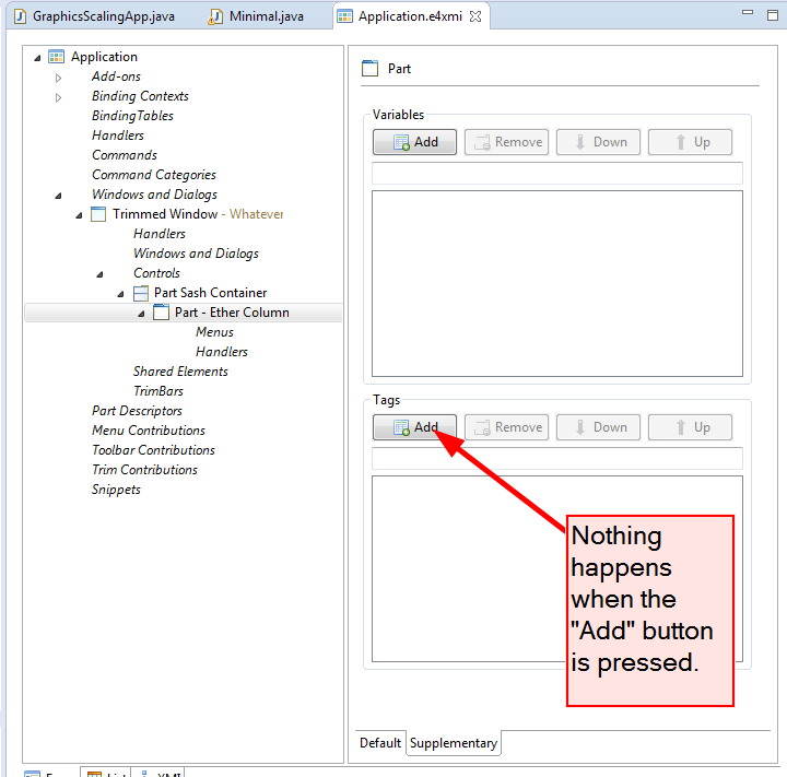

Eclipse for RCP and RAP Developers
Version: Mars Release (4.5.0)
Build id: 20150621-1200
The add button is no-op when pressed.
index.php/fa/22948/0/
Re: Syntax to DI AnchorPane [message #1705628 is a reply to message #1705627] Mon, 17 August 2015 20:16 Go to previous messageGo to next message
Type your content into the text box first, then press "Add." (The single line text box, just below the row of buttons.)
[Updated on: Mon, 17 August 2015 20:18] by Moderator
Re: Syntax to DI AnchorPane [message #1705646 is a reply to message #1705627] Tue, 18 August 2015 02:35 Go to previous messageGo to next message
You might please file a bug to the editor to disable the button until
you have typed a value into it.
Tom
Re: Syntax to DI AnchorPane [message #1705691 is a reply to message #1705628] Tue, 18 August 2015 08:06 Go to previous messageGo to next message
The following steps have no effect within the "Tags" group in the "Supplementary" tab of the e4xmi editor.
Clicking in the text box, then typing.
Right clicking in the text box.
Left clicking in the text box then typing.
Pressing the add button.
Bug 475261 has been submitted.
Re: Syntax to DI AnchorPane [message #1705749 is a reply to message #1705691] Tue, 18 August 2015 14:43 Go to previous messageGo to next message
Paul,
Are you clicking in the single line text field, or the multi-line text box? You need to enter your tag data in the single line text field. Then, after you click ADD, the content will be added to the text box. Since you can supply multiple tags, each tag shows as a separate line in the text box after add. I have successfully added a "container:AnchorPane" tag in Luna using this method and then successfully used the pane with the new specification. (I have not yet upgraded to Mars and e(fx)clipse 2.x, so cannot speak for the current release.)
FYI - the remaining buttons are activated when you click on data that has been entered, in order to edit the content of the text box ... removing tags, or adjusting arrangement.
Re: Syntax to DI AnchorPane [message #1705750 is a reply to message #1705749] Tue, 18 August 2015 15:00 Go to previous messageGo to next message
Embarrassed
Thanks Joe:
What threw me off was the fact that the "Add" button on both "Default" and "Supplementary" tabs of the "Part" are the same. Then when a user clicks on any of the "Add" buttons on the "Default" tab they all bring up a dialog. But, when a user goes to the "Supplementary" tab both "Add" button behave different than the "Default" tab. The cursor does not give focus to the one line text box on either "Variables" or "Tags". I will remove the bug report.

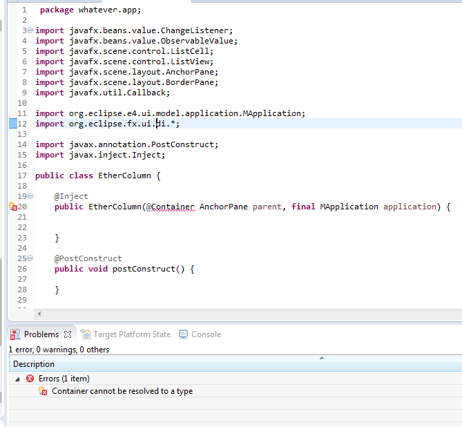

Re: Syntax to DI AnchorPane [message #1705752 is a reply to message #1705749] Tue, 18 August 2015 15:18 Go to previous messageGo to next message
I am still not doing something correctly.
index.php/fa/22954/0/
index.php/fa/22955/0/
Re: Syntax to DI AnchorPane [message #1705753 is a reply to message #1705752] Tue, 18 August 2015 15:29 Go to previous message
Try:
	@PostConstruct
	public void postConstruct(AnchorPane parent, ...
