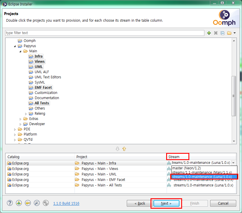

> <image>

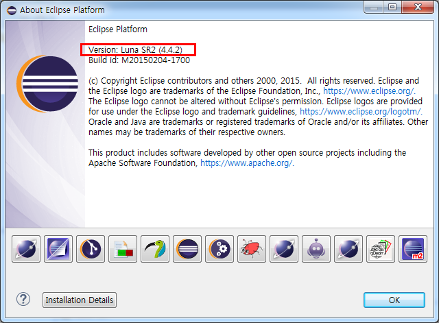

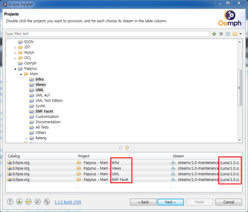

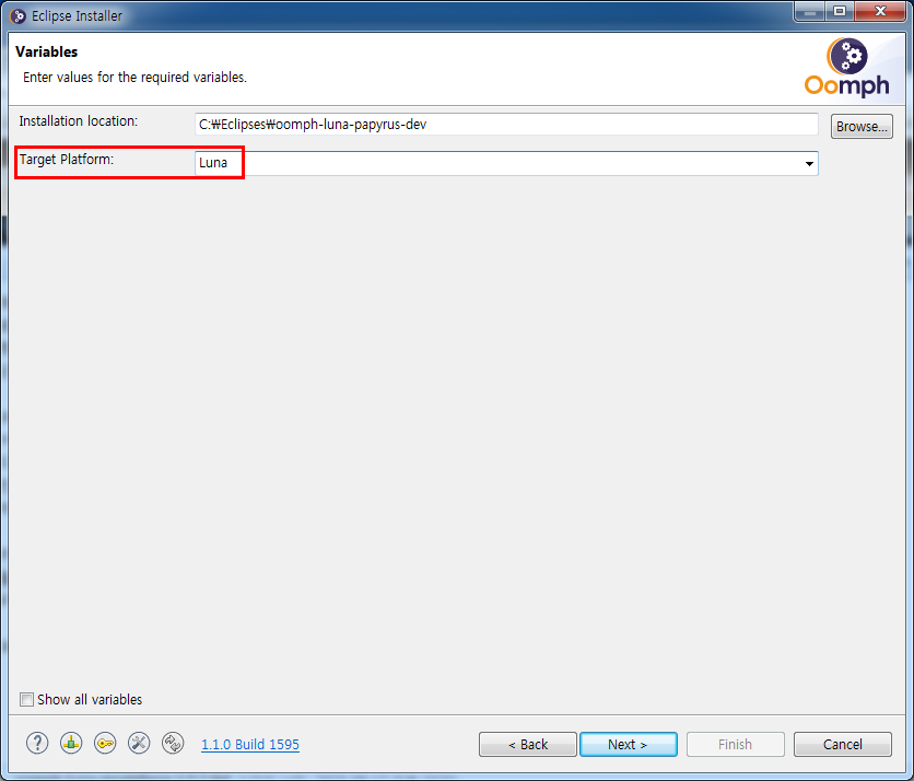

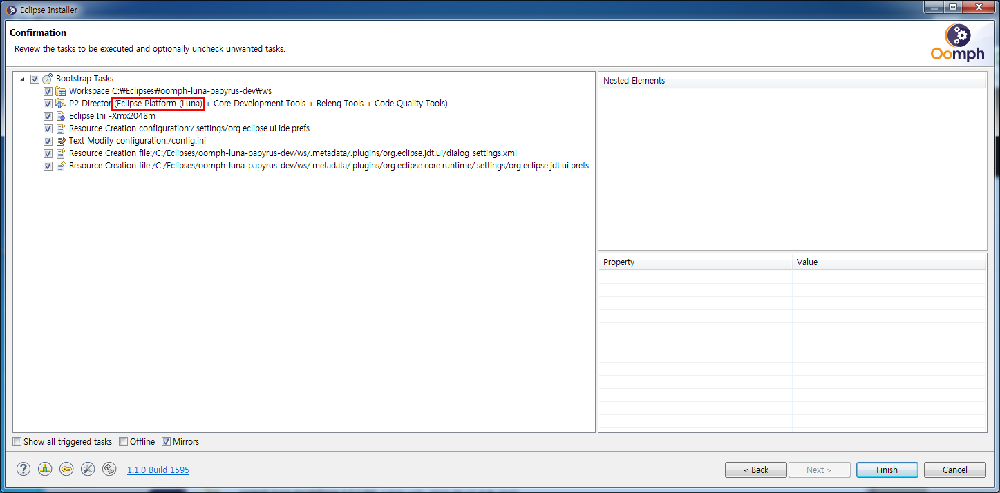

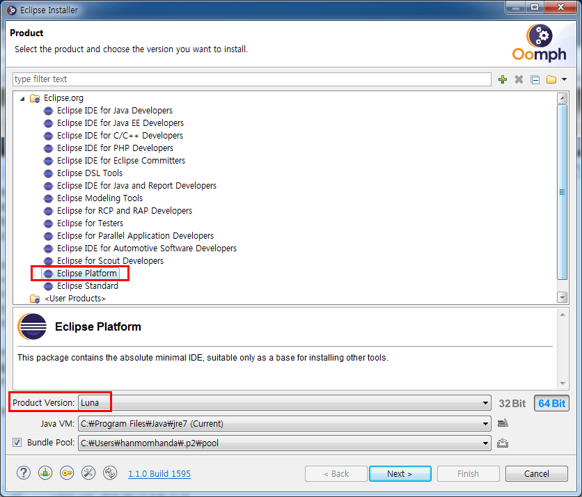

Re: Oomph-Luna-Papyrus installation Error [message #1705569 is a reply to message #1705564] Mon, 17 August 2015 10:35 Go to previous messageGo to next message
Thank you for the quick answer.
This is what i've done.
I chosed 'Luna' whenever I could specify a platform version.
index.php/fa/22926/0/
index.php/fa/22927/0/
index.php/fa/22928/0/
index.php/fa/22929/0/
index.php/fa/22930/0/
I removed the 'All Tests' from selection, but it still produces the same error.
If this is a bug, how can I report this as a bug?
