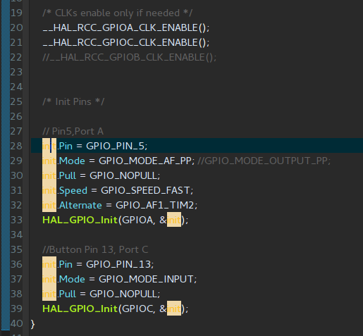

since my Eclipse is updated to Mars the complete design is diffrent, but thats not the problem because I like it, but now Eclipse marks the word were the cursor is and also all word with the same sense.
How I can disable that?
Martin
  • Attachment: pic1.png
    (Size: 51.91KB, Downloaded 134 times)
Re: Eclipse marks the word were the cursor is and all same worda [message #1705302 is a reply to message #1705174] Thu, 13 August 2015 11:22 Go to previous messageGo to next message
That looks like the Mark Occurrences feature. It can be toggled on and off via a keyboard shortcut and/or a toolbar button. I think the default keyboard shortcut is Alt+Shift+O.
See this for more details: http://stackoverflow.com/a/21366921/639520
Re: Eclipse marks the word were the cursor is and all same worda [message #1705405 is a reply to message #1705302] Fri, 14 August 2015 13:59 Go to previous message
Yes it worked. Thank You!! Smile
