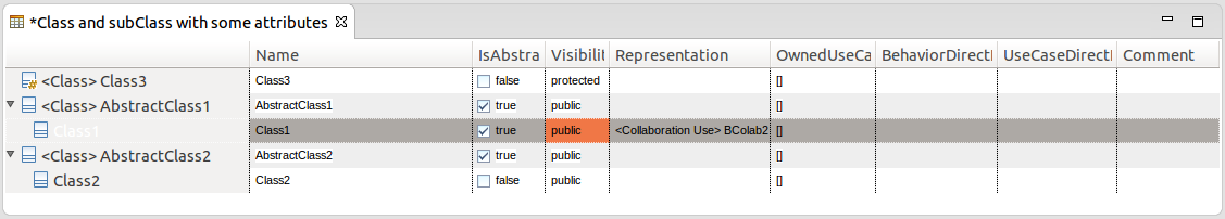

I think you talk about "Table representation".
In the screenshot "tableSample.png" (extract from tests of Sirius:
/org.eclipse.sirius.tests.junit/data/table/unit/refresh/tables.aird),
the entire selected row has a specific background color. There is
nothing specific to configure for that. This is the default behavior.
I am not sure to understand your problem...

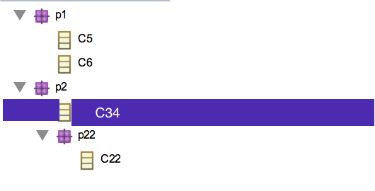

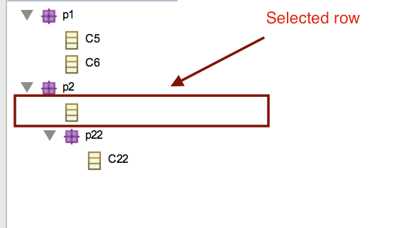

Re: Row selector for Tree diagram [message #1705170 is a reply to message #1705168] Wed, 12 August 2015 11:10 Go to previous messageGo to next message
Take a look at attachments
Arseniy Isakov

This seems to corresponds to
https://bugs.eclipse.org/bugs/show_bug.cgi?id=460810 which has been
corrected on master and will be available for Sirius 3.1
Maxime - Obeo
