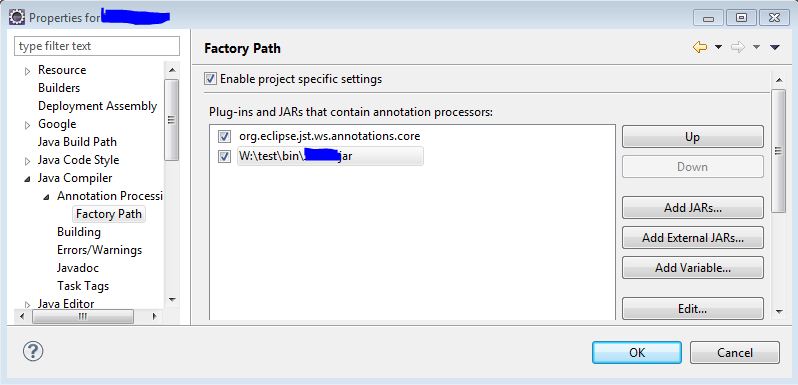

I'm running Eclipse Kepler and compiling with JDK6. I have code tagged with an annotation that gets processed by an annotation processor in an external jar which has been configured in the Factory Path setting of the Java Compiler. The annotation processor produces several xml files and a .java class to be included in the build.
index.php/fa/22862/0/
The build works fine until I right click my project and refresh to pull in external jar changes (not the annotation processor jar). The xml files and .java no longer get produced indicating to me the annotation processor is failing. However, I cannot find a way to view the javac logs in Eclipse. Once I restart eclipse and build again, it's fine.
I can't find a way to view the output of javac. Apparently this is because of the integration into Eclipse. I have the Problem view configured to show all errors but there is nothing indicating any errors in annotation processing.
Does anyone have any idea what's going on behind the scenes and how to rectify this?
  • Attachment: Capture.JPG
    (Size: 51.59KB, Downloaded 1407 times)

Let me try to understand the scenario.
1. There are bunch of external JARs in the build path of the project. And the project has been configured with an annotation processor that resides in an external JAR and when you refresh from package explorer (or is it project explorer) the XML and Java files that the processor supposed to be generating are not present. Assuming my understanding is correct, I have some questions:
1. Is the external JAR that has the processor - is that also part of the project's build path?
2. Can you open the log file and see if there's anything relevant there? You can find it in <workspace_location>/.metadata/.log
BTW, Eclipse has it's own compiler and doesn't use Javac for compiling.
