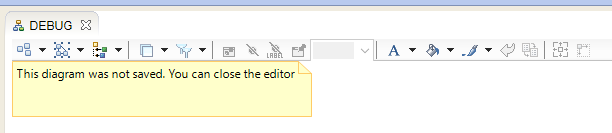

The diagram indicates that, even though the style has changed, no changes have been made. The * indicator is missing, which is weird since the diagram obviously is changed.
And when I relaunch the Eclipse instance, the diagram is gone. All I see is a message that says that the diagram was not saved. See attached screenshot.
This part is normal (or at least expected) given the previous problem:
if you exit Eclipse with an editor open, it (the Eclipse workspace) will
try to reopen an editor on the diagram, which was never saved on disk
and thus does not exist after the restart.

I am using Sirius 2.0.0 at the moment. I am not sure whether I am able to try v3.0.0 or not, but I will definitely check it out.
I am trying to build a graphical visualization tool for the Autosar metamodel and the metamodel is an ecore file. The generation of diagrams are working perfectly, so I find it really weird not being able to save.
Any ideas?
[UPDATE]
I managed to make the star be present, so now the change detection is working. However, when pressing Save (Ctrl + S) nothing happens, the star is still there. How does the save process work?
[UPDATE 2]
I have found that the changes are actually written to the representations file when I hit save, but the changes indicator are still present. How do I make sure that the most recently saved diagram, if one exists, is loaded when I regenerate the diagram?
