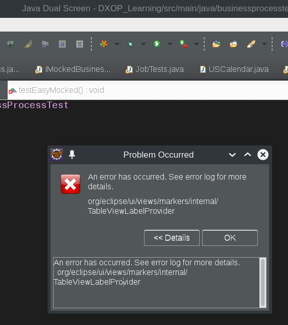

Hello all,
I have a copy of eclipse open that, every time I try to close it, instead of closing, it pops up this error:
index.php/fa/22753/0/

Should I report this as a bug?
