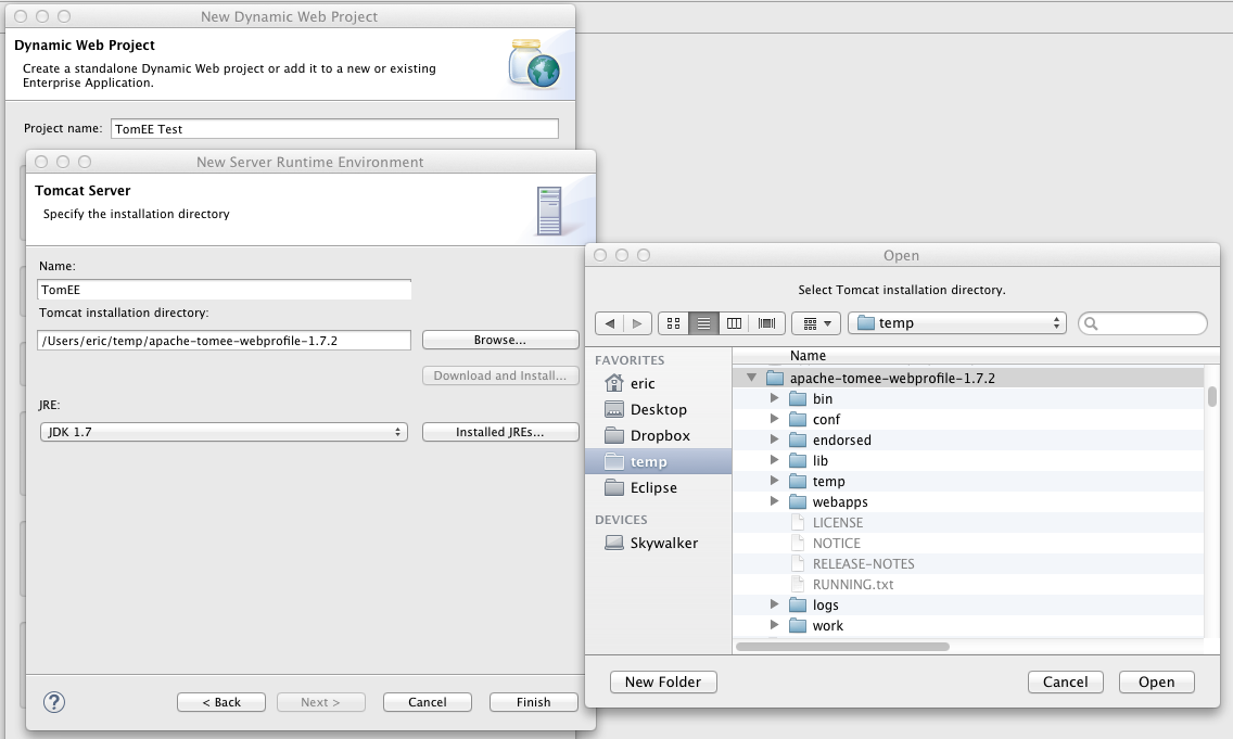

I just followed the instructions at http://tomee.apache.org/tomee-and-eclipse.html and it seemed to work fine. Here's a screen shot:
index.php/fa/22755/0/
Do you see anything noticeably different than what you tried?
  • Attachment: Untitled.png
    (Size: 117.20KB, Downloaded 6342 times)
Re: Eclipse doesn't recognize TomEE [message #1703636 is a reply to message #1703630] Mon, 03 August 2015 14:24 Go to previous messageGo to next message
Yes: your TomEE directory seems to be recognized as a Tomcat installation (the 'Download and Install...' button is de-activated and there's no proposed Tomcat version to download).
