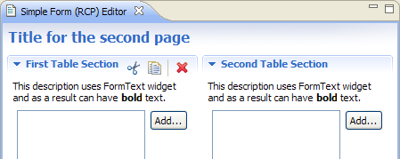

1. I the screenshot below and at various places in the plug-in manifest
editor you can see actions at the right side of a sections header.
http://www.eclipse.org/articles/Article-Forms33/images/secti on-aligned.png
How can I add the actions to this position?
Can there be delegated from extension points?

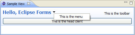

2. Within a FormEditors header a toolbar and a menu can be defined:
http://www.eclipse.org/articles/Article-Forms33/images/form- menu.png
Is it possible to delegate actions and menus to this places using
extension points? Until now I delegated every action within my plug-in
using org.eclipse.menus and it would be sad to break this paradigm here.
The forms article should have mentioned how to add actions to the
section menu and section toolbar, probably using a ToolBarManager and a
MenuManager.
While you don't get any extension point for free, you can hook in any
contribution manager that you control the lifecycle for. Use
org.eclipse.ui.menus.IMenuService.populateContributionManage r(ContributionManager,
String) and
org.eclipse.ui.menus.IMenuService.releaseContributions(Contr ibutionManager),
and make up a unique internal ID.
PW
