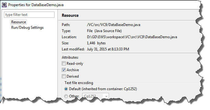

Good question Nitin. As far as I know it does not exist anywhere other than a copy pasted in to a MS Word document where I am writing up this issue.
I did check the properties of the source code in Eclipse and the path and file is just as I expect and opening up the source code by way of Note Pad shows just the current most recent update text.
My conclusion is that the text that is brought up is NOT what is being executed. Maybe there is some 'compiled' version that is being executed.
The old version of the code is set up to pull data from a MySQL table and the current text is set up to pull data from an Oracle table. The tables are very different. But what gets displayed in the console is data from the MySQL table.

Re: Weird, why is some previous version of a class running [message #1703531 is a reply to message #1703530] Sun, 02 August 2015 11:37 Go to previous messageGo to next message
ah, maybe in regular reply I can attach a picture.
index.php/fa/22742/0/
x

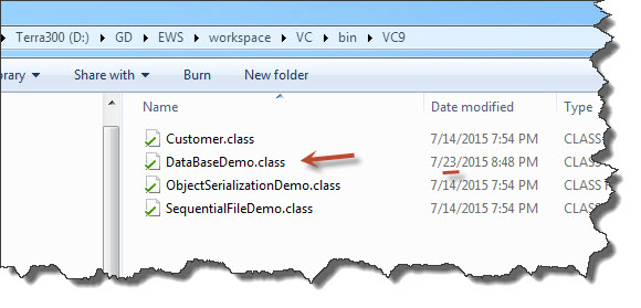

Re: Weird, why is some previous version of a class running [message #1703546 is a reply to message #1703545] Sun, 02 August 2015 20:11 Go to previous messageGo to next message
index.php/fa/22744/0/
Re: Weird, why is some previous version of a class running [message #1703553 is a reply to message #1703546] Mon, 03 August 2015 00:21 Go to previous messageGo to next message
Search your system for filenames that match the ones giving you old behavior.

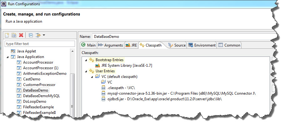

  • When you run your application/program in Eclipse, it creates (or re-uses) what's called a Launch Configuration to create the runtime settings, such as runtime classpath, VM arguments, etc. You can view the Launch Configs via the Run > Run Configurations... dialog from the menu. There you can inspect how your program is being run.
So, does your Problems (or Markers) view show any errors on the project or the file you're working with?
Can you take a screenshot of the Run Configuration for your program and share that? (also inspect it yourself to see if there's anything obviously suspicious in it).

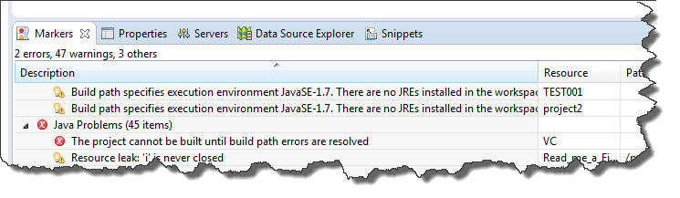

Re: Weird, why is some previous version of a class running [message #1703662 is a reply to message #1703627] Mon, 03 August 2015 21:51 Go to previous messageGo to next message
This is what I saw before the Project > Clean in the Markers.
Which solved that problem.
But the Markers still looks the same.
index.php/fa/22756/0/
but now I am getting
index.php/fa/22757/0/
[Updated on: Mon, 03 August 2015 21:52] by Moderator
Re: Weird, why is some previous version of a class running [message #1703663 is a reply to message #1703662] Mon, 03 August 2015 23:32 Go to previous messageGo to next message
As the first Java Problem indicates, there's a build path error on the VC project. You might be able to get some assistance by right-clicking on that error and choosing Quick Fix..., but instead why don't you right-click on the VC project and open its Properties dialog. Then select the Java Build Path section and see if there is any detailed message about the error.

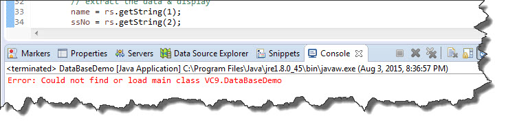

For some reason all the source codes *.java has lost all connection to the class files.
In fact, when I checked there were no longer any files in
D:\GD\EWS\workspace\VC\bin
So of course I get the error 'Could not find or load main class'...
Before I discovered that I made a new package and made a new source member and ran that.
Low and behold it worked.

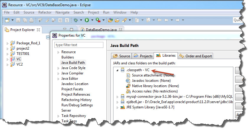

Re: Weird, why is some previous version of a class running [message #1703800 is a reply to message #1703785] Wed, 05 August 2015 02:04 Go to previous messageGo to next message
.classpath is the file that stores and defines what the Java Build Path is, it shouldn't actually be listed on the Java Build Path.
Can you show us the contents of the .classpath file? My suspicion is that the src folder itself may not be listed as a Source Folder in there.
Re: Weird, why is some previous version of a class running [message #1703928 is a reply to message #1703800] Wed, 05 August 2015 17:57 Go to previous messageGo to next message
here it is:
<classpath>
	<classpathentry kind="src" path="src"/>
	<classpathentry kind="con" path="org.eclipse.jdt.launching.JRE_CONTAINER/org.eclipse.jdt.internal.debug.ui.launcher.StandardVMType/JavaSE-1.7"/>
	<classpathentry kind="lib" path=".classpath"/>
	<classpathentry kind="lib" path="C:/Program Files (x86)/MySQL/MySQL Connector J/mysql-connector-java-5.1.36-bin.jar"/>
	<classpathentry kind="lib" path="D:/Oracle_Exe/app/oracle/product/11.2.0/server/jdbc/lib/ojdbc6.jar"/>
	<classpathentry kind="output" path="bin"/>
</classpath>
and a pic
index.php/fa/22802/0/
  • Attachment: classpath.jpg
    (Size: 148.76KB, Downloaded 7731 times)

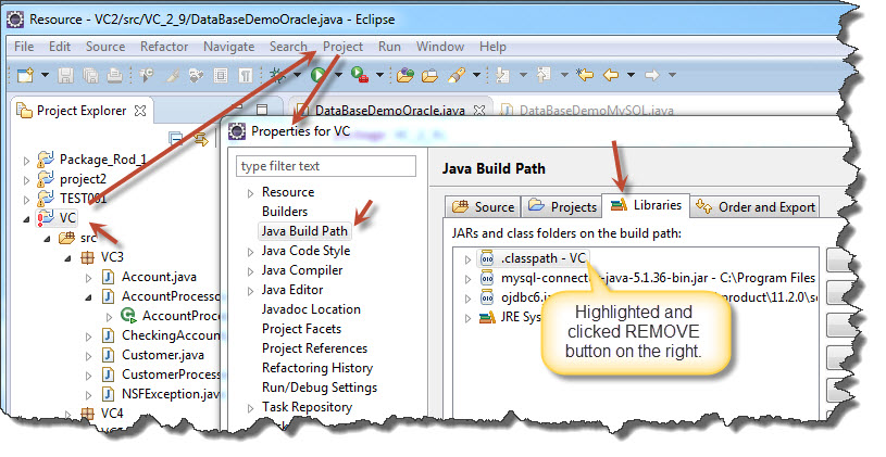

Re: Weird, why is some previous version of a class running [message #1703933 is a reply to message #1703928] Wed, 05 August 2015 18:34 Go to previous messageGo to next message
Remove the .classpath entry from that tab, then flip over the the Source tab and use the "Add Folder..." button to add the "src" folder to the list.

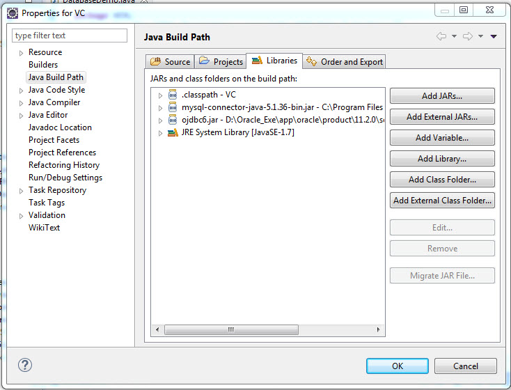

Re: Weird, why is some previous version of a class running [message #1703942 is a reply to message #1703933] Wed, 05 August 2015 21:19 Go to previous messageGo to next message
Nitin,
I did "Remove the .classpath entry from that tab"
index.php/fa/22803/0/
But for "then flip over to the Source tab and use the "Add Folder..." button to add the "src" folder to the list." did not make sense to me as the folder "src" was already there. I did add another folder named "George" but that did nothing for me so later removed it.
The good news is that when I went back to my project "VC" and then went down to any of the packages and opened them up and selected one of the classes and then ran it and it worked! So now I don't have to try to recreate anything.
Thank you all very much.

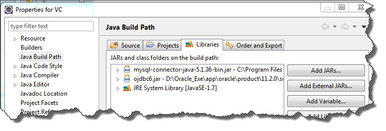

Re: Weird, why is some previous version of a class running [message #1703943 is a reply to message #1703942] Wed, 05 August 2015 21:25 Go to previous messageGo to next message
I will add one more note. In Libraries that classpath you had me remove before is no longer there after things started working again. And that is part of the point. I don't know why it was ever there that it needed to be deleted. All the other projects don't have such a thing either.
index.php/fa/22804/0/
