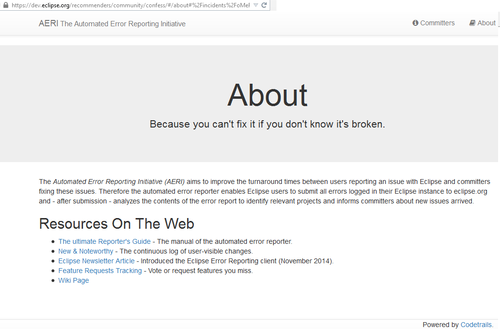

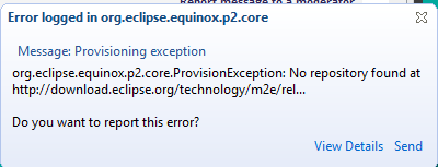

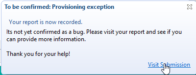

Today as soon as I got the first of those errors in Eclipse (see 1.png), I clicked "Send", got 2.png, clicked "Visit submission" and got 3.png (whose URL is https://dev.eclipse.org/recommenders/community/confess/#/about#%2Fincidents%2Fr6T060rPLnYP3DUw0pMGmo54EtPotaQBWhEM8ErOAI5qT8bGR8d2hWyEHUe2dDP4 ).
Then I got further errors and every time I tried to do the above it went the same way.
I hope this helps and if you would like more info you are welcome to ask, however if you look into this please do so at your own discretion, this is mostly FYI, I don't need further assistance.

The screenshots helped to fix the wrong url. Thanks Davide.
