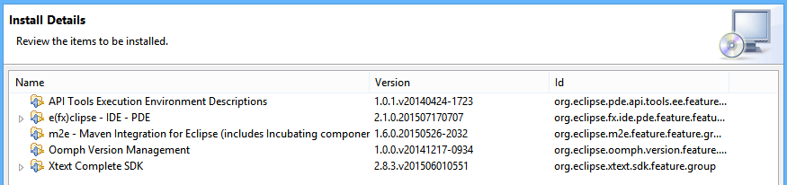

index.php/fa/22690/0/
As specified in the GEF contributor guide, the GEF-IDE consists of

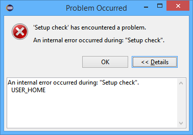

After installing the Oomph Version Management Tool plug-in, at the next Eclipse Startup I see the following error:
An internal error occurred during: "Setup check".
USER_HOME
I was actually thinking my install was ok, but in bugzilla, I got that I did an "inconsistent installation" - see bug 473599.

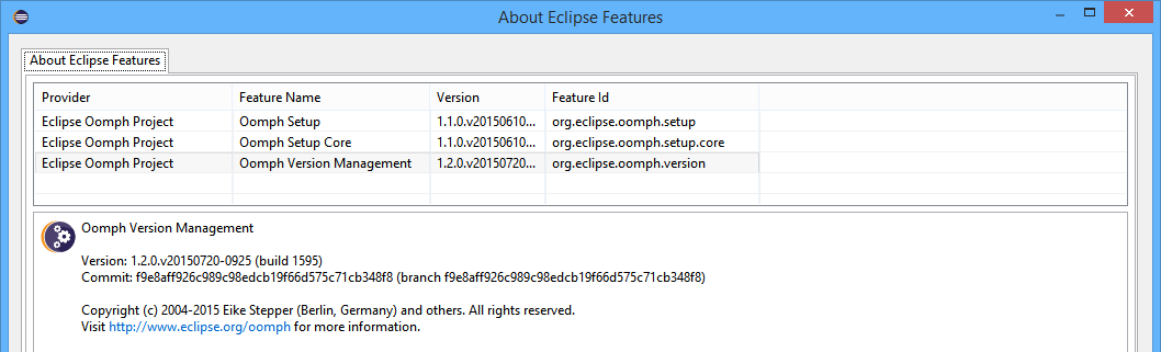

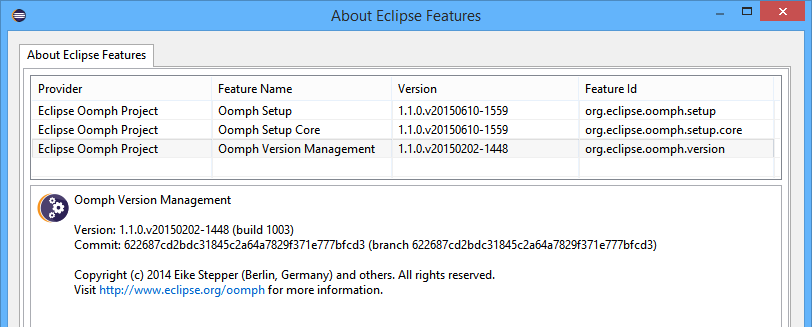

Indeed, I checked in the About eclipse features for the Oomph, and I saw the Version Management Tool version is not matching with Oomph Setup Core , but only for a small "delta"
index.php/fa/22693/0/

I'm not 100% sure but I think you can't easily get out of this inconsistent state because the plugins that would do that
for you are also impacted. I would recommend that you create a new installation with Oomph's Eclipse Installer.

Oh, and probably you should install the Version management from the Mars repo and not from Oomph's (newer) update site.
