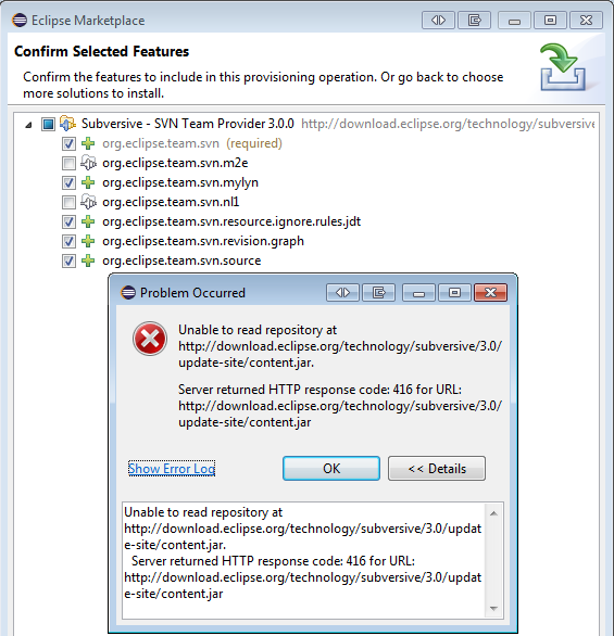

I can open the Marketplace and it actually shows all the plugins, I can select one for install and the plugin-dependency-tree is show, but the next step fails with the following message:
index.php/fa/22686/0/

Unable to read repository at http://download.eclipse.org/technology/subversive/3.0/update-site/content.jar.
java.io.IOException: Server returned HTTP response code: 416 for URL: http://download.eclipse.org/technology/subversive/3.0/update-site/content.jar

Check for Update shows the same result.
I tried googling for this kind of error, but it seems no one has reported this problem so far. I'm a little bit lost what to do now (apart from using Luna again), since exactly the same configuration is working in Luna, but is unusable for me in Mars. The network access seems to work because Mars can load the dependency tree of a Marketplace plugin. Every other combination in the network settings fails because of the corporate proxy.
So, any suggetions how to find the root cause? It's quite possible the corporate proxy is misconfigured, but I hope you can help me finding the difference between the working Luna and the (for me) broken Mars, so I know what has to be configured differently. Something seems to be changed in the way the packages are downloaded.
