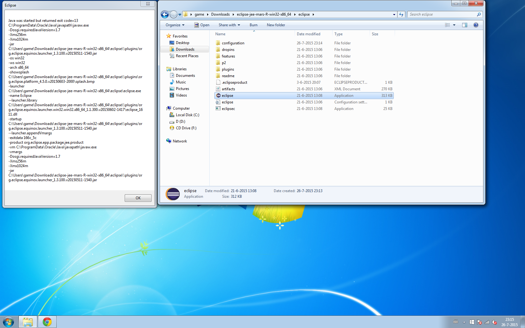

hello,
i installed eclpise and cant run t, it says
''java was started but returned exit code =13''
now i already saw some solutions but none of them worked for me,
i got a few pictures added to this post, can someone please helpme.

You have not followed the instructions in that message correctly. Specifically, you have not specified the location of your 64-bit JVM in eclipse.ini (as evidenced by the "error 13" dialog you showed. See the -vm line? It's incorrect. Please read the instructions carefully.
