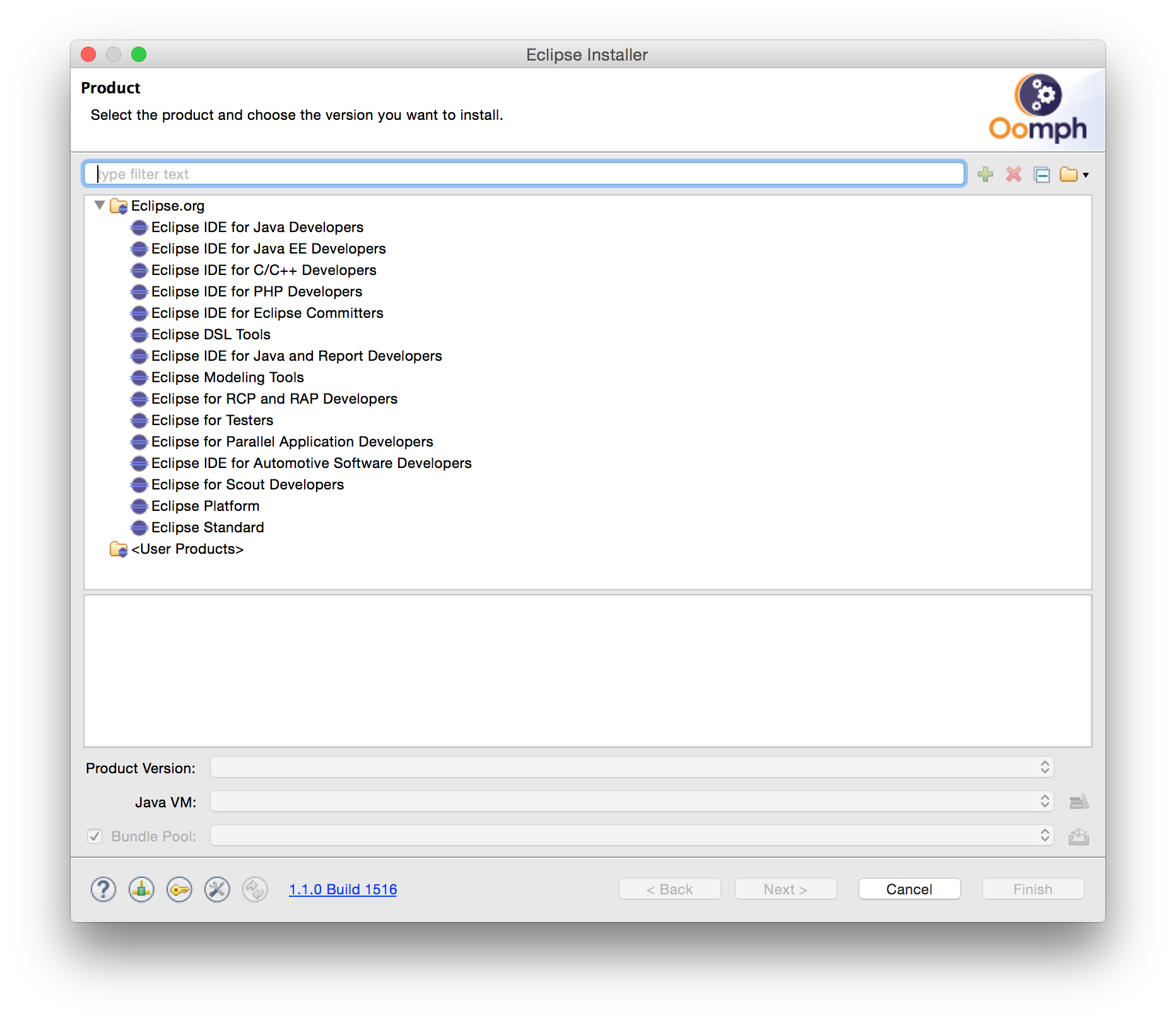

So I tried again, and until now always only get the products in the screenshot attached. I cannot somehow refresh it to get github or all eclipse folders back.
That screenshot shows the first "Product" page, with which you don't seem to have an issue. A screenshot of the second
"Projects" page would have been more helpful to see your problem with the OpenHAP project. Can you send that screenshot,
please?
I'm not sure what you mean. You seem to confuse the Product with the Projects page. We removed all refresh buttons a
couple months ago becaue refresh now happens automatically in the background.

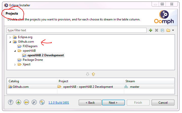

Again, on the *first* page you've never seen a Github.com catalog. That one is on the *second* page. I've attached a
screenshot...
