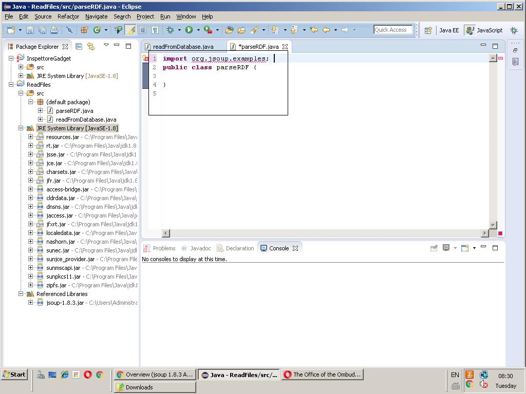

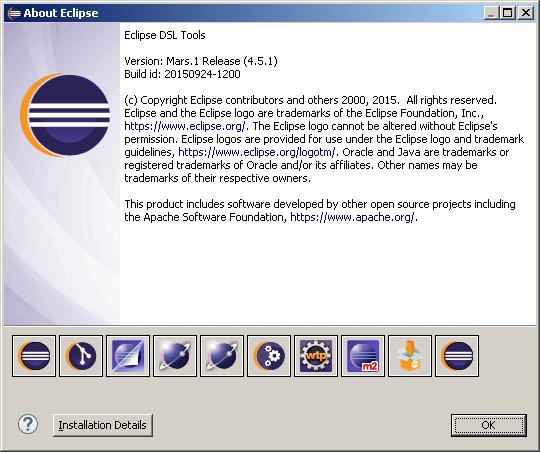

I have a similar problem, I added jars to the build path and I cannot reference the libraries according to the examples documented at http://jsoup.org/. I have also tried other technical options but no joy as yet.
I did some reading online but I did not yet find a tutorial which helps me get up and running as yet.

have you tried to change the classpath order? In your second screenshot I see that your sorce is above the libraries. Change this via right click on the project -> Build path -> Configure Build Path... -> Switch to the tab Order and Export and move your source folder to the bottom.
