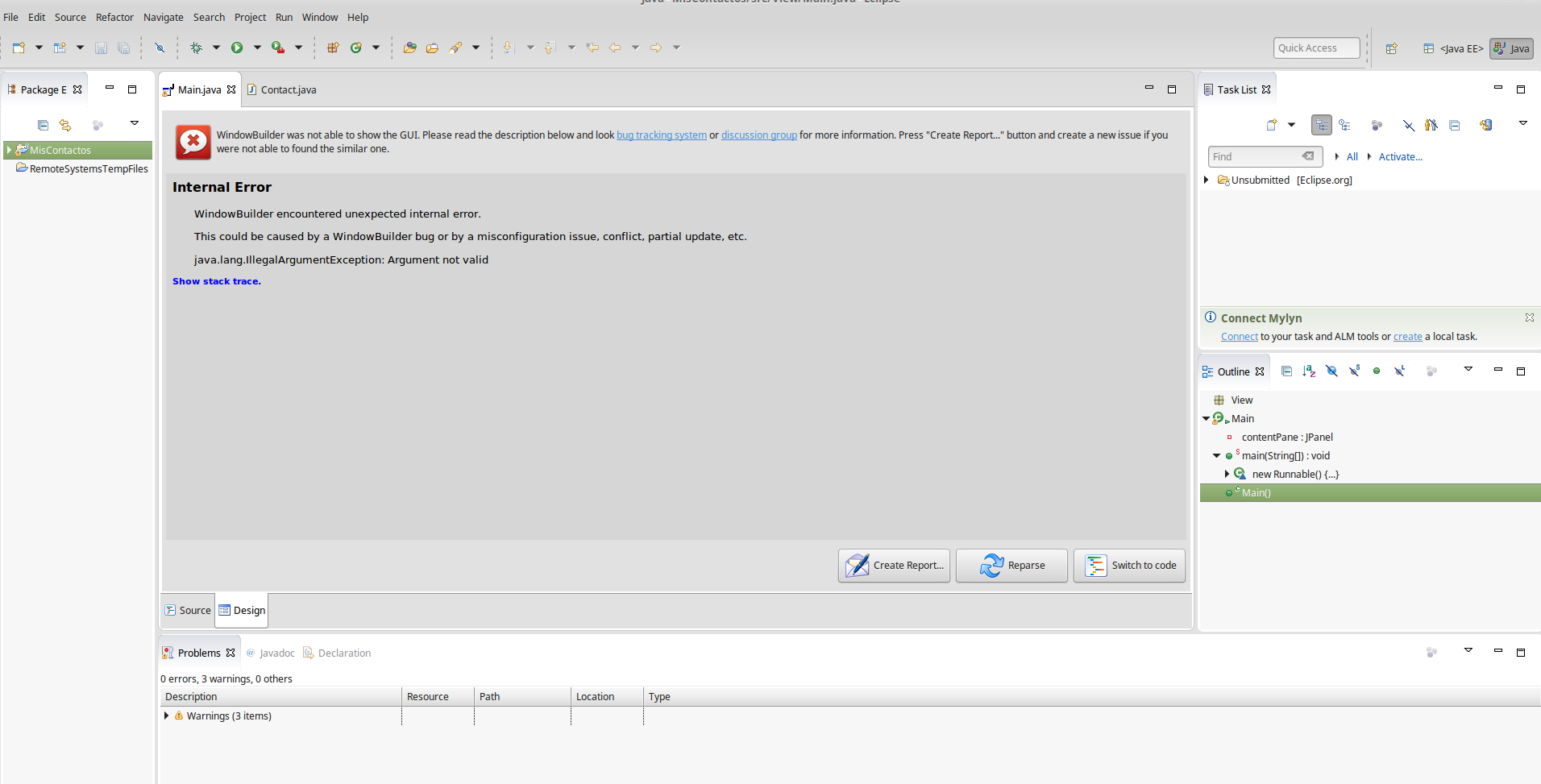

Crashing WindowBuilder and I invisible structure in Eclipse Mars [message #1702087] Sun, 19 July 2015 07:05 Go to next message
I have Eclipse Mars in Linux Mint. When I create a project java with jframe with design in WindowBuilder, the system crashed. For a time it works and then disappear view of structure components and eclipse crashes.
The output of terminal is in file terminal.txt
Sorry for my English

I have exactly the same problem.
Linux Mint Cinnamon 17 x64
Oracle Java 1.7
I was using Eclipse Juno previously, and Windowbuilder would often hang Eclipse.
Updated to Mars (x64) today, and now even with a simple frame, Windowbuilder crashes and hangs Eclipse completely. I have to kill it via the kill command.
Tried searching for updates, but no updates found
This is not good, folks!
Windowbuilder works just fine under Windows, but certainly not in Linux.
Please fix asap, or suggest a more stable GUI designer.
Unfortunately, I can't "Create Report" or "Reparse" as the whole app has hung.
