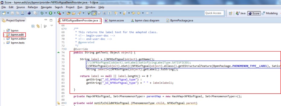

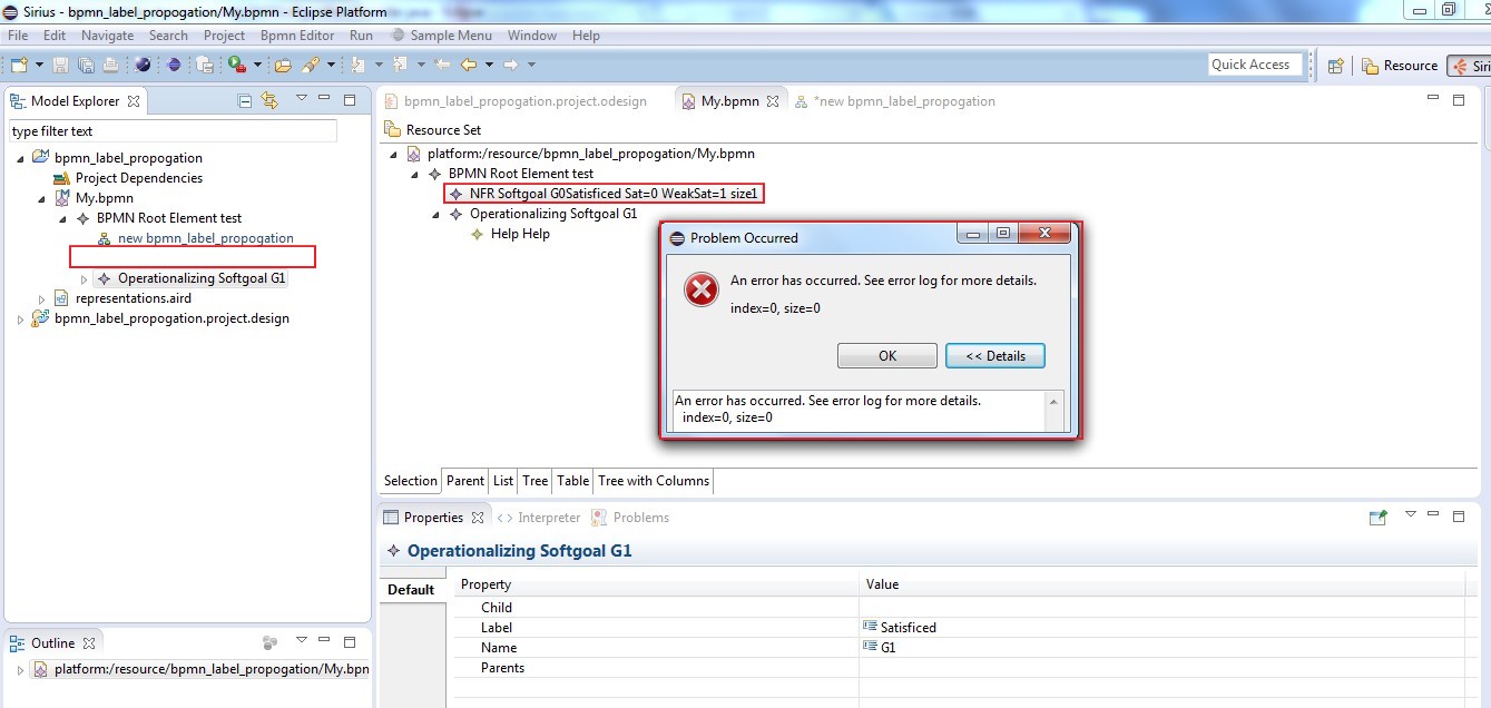

Hi All,
I want to set a field value of a class. I do this in the way of modifying codes in getText() method in XXXItemProvider.java as the red frame in the following picture.
index.php/fa/22506/0/
It generates the following problem
index.php/fa/22505/0/
But, if I remove the codes, "(NFRSoftgoal)object.setLabel......", it becomes normal.
Can anyone help me solve the problem?

Modifying an instance's state in an item provider's getText method is
not appropriate. Such methods should be side-effect free. State
changes to the model should happen only in commands.

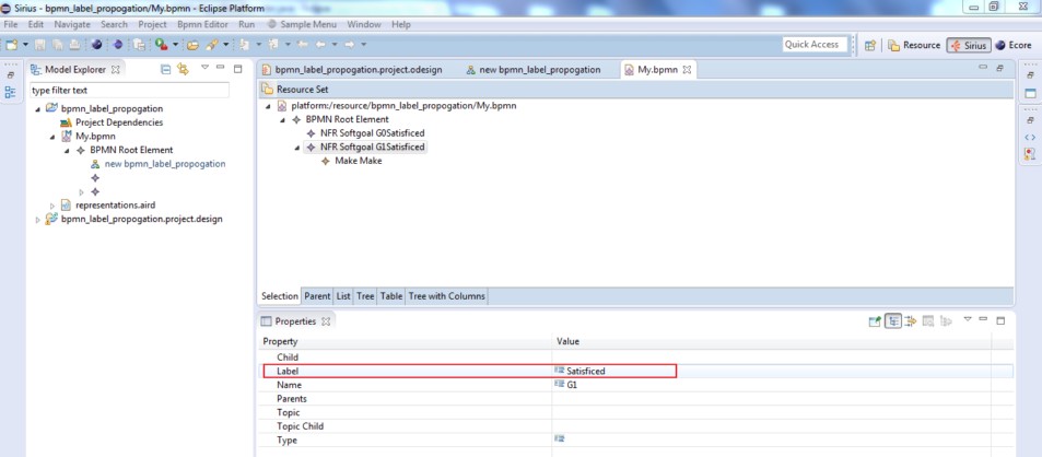

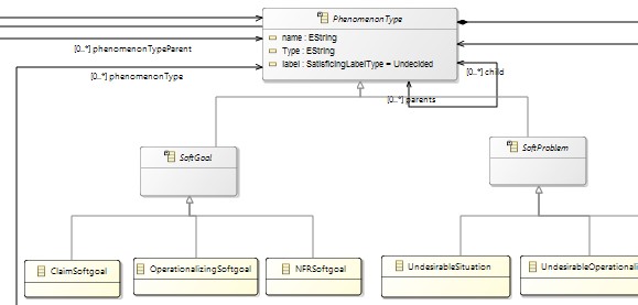

Re: Set field value problem [message #1701944 is a reply to message #1701788] Thu, 16 July 2015 22:40 Go to previous messageGo to next message
(1) My model structure (I want to change label attribute.):
index.php/fa/22547/0/
(2.1) Before (Child and parent clouds are undecided. Cloud represents NFRSoftgoal class.):
index.php/fa/22548/0/
(2.2) After (After child cloud changes to satisfy through command, parent cloud changes to satisfy automatically.)
index.php/fa/22549/0/
  • Attachment: q1.jpg
    (Size: 27.83KB, Downloaded 399 times)
  • Attachment: q2.jpg
    (Size: 4.19KB, Downloaded 415 times)
  • Attachment: q3.jpg
    (Size: 4.59KB, Downloaded 381 times)
Re: Set field value problem [message #1702009 is a reply to message #1701944] Fri, 17 July 2015 08:28 Go to previous messageGo to next message
Comments below.
So the label feature is on a class that's the root of a several other
classes...
This undecided thing is the default state...
Is this via a command that directly modifies the label feature of the
"child"? If so, that's the place to modify the state of the parents,
e.g., using a compound command that modifies the child as normal, and
walks up the parents to modify the parent label also using commands.
What, if anything, prevents the "parent" label from being directly
changed back to undecided (which is perhaps an inconsistent state for
the model)?

-----> I change the label feature of "child" through the red frame in the following pictures (This is under run-time application and Sirius environment.):
index.php/fa/22556/0/
-----> But I don't want to change the label feature of "parent" through the same way, because it should be automatically changed, not manually.
That's why I modified the code of getText( Object object) function in NFRSoftgoalItemProvide.java under bpmn.edit.
index.php/fa/22557/0/
-----> What do you mean "via a command" ? I don't know how to change via a command. Could you explain or give any reference for it?
Thanks & Regards,

I'm asking what's preventing that from happening? I suppose it doesn't
matter if you've done something so that only a leaf/child can be
directly modified.
That's not a good idea.

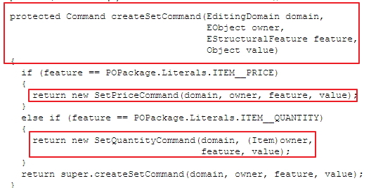

On the child, the set command is created by
org.eclipse.emf.edit.provider.ItemProviderAdapter.createSetCommand(EditingDomain,
EObject, EStructuralFeature, Object) so you can specialize this method
of the child's item provider so that it modifies not only the child's
label feature, but modifies also the parents. All that could be done
with a CompoundCommand that composes all the SetCommands.

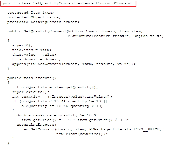

Re: Set field value problem [message #1702235 is a reply to message #1702051] Mon, 20 July 2015 18:09 Go to previous messageGo to next message
I do want to prevent modifying parent's attribute value after child label going up.
I saw the example of using createSetCommand in EMF book.
createSetCommand is added in the **ItemProvider.java
index.php/fa/22582/0/
But which package should SetPriceCommand and SetQuantityCommand been added into? Is it **.provider package in **.edit?
index.php/fa/22583/0/
Thank you.

Re: Set field value problem [message #1702242 is a reply to message #1702235] Mon, 20 July 2015 20:01 Go to previous messageGo to next message
You should learn some debugging techniques to answer questions like this
yourself. For example, set a breakpoint in the setLabel method. See
when it gets called when you change the child's label. You'll discover
it's in the SetCommand. Then set a breakpoint in the constructor and
you'll see when that command is created. You'll see which
XyzItemProvider is doing that; well it will be in the base
ItemProviderAdapter, but in the debugger you'll see which derived class
is involved. That's where you can specialize the method.
In other words, use the debugger to find your answers. I often work
with frameworks where no one will answer my questions and I still need
to figure out how they work and how I can specialize how the work...

On 21/07/2015 6:00 PM, Shin-Yi Lin wrote:
> Thanks for your suggestion.
> I've set the breakpoint at setLabel method before you mentioned. It's
> not in the SetCommand; rather, it is in the PhenomenonTypeImp.java.
Yes, the set methods are in the implementation classes. The point is to
set a breakpoint and look at the call stack to see who is calling it.
> In addition, SetCommand is actually in
> org.eclipse.emf.edit.command.SetCommand.
Indeed. Do you know that Ctrl-Shift-T will let you find any class easily.
> From the EMF book, setPrice and setQuantity which extend SetCommand
> are classes, which means I should create a class java file for them.
> This really confused me. ------> From your suggestion. I guess I
> should specialize the setLabel method and extends from SetCommand in
No, I was quite specific about specializing your generated item provider.
