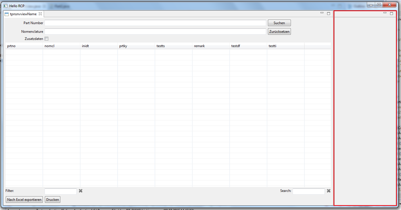

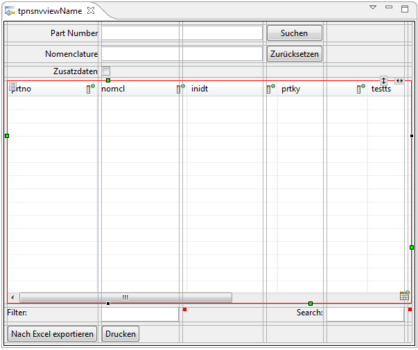

1.) I am using the Grid Layout. While the design looks well (see picture 1), during runtime the GUI has the drawback that the label and text widgets move/grow to the right side. How is it possible to avoid this?
2.) Does anybody know how to prevent RCP from painting the part which is highlighted in red on the second picture?

Sorry, I rarely look in the SWT forum. But as you asked me via email, I try to answer your questions in order to help you with your master thesis.
1. If you are using a GridLayout, it seems you have set a GridData that uses the grab attributes. If you don't specify them, they shouldn't grow. Specifying the correct GridData should solve your issues. The GridDataFactory is something to look at.
https://www.eclipse.org/articles/article.php?file=Article-Understanding-Layouts/index.html
2. It is a second part, so you have configured it somewhere. Are you using Eclipse 3.x or 4.x? Without knowing about your setup it is hard to tell. In Eclipse 4 I would suggest to look at the application model and remove the part/partstack you don't need.
