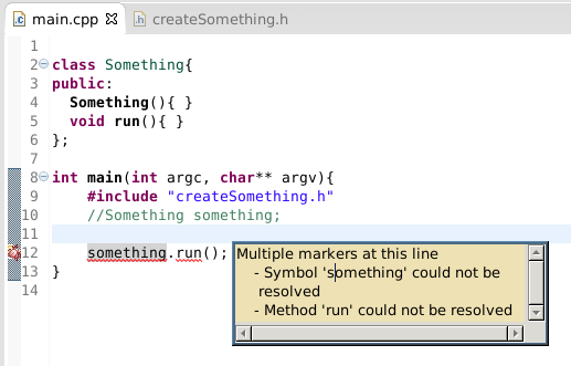

I have a problem with the C++ indexer (Eclipse Luna CDT).
My test project contains two files: main.cpp and createSomething.h (see below)
The Editor doesn't recognize that the symbol "something" is declared in the preprocessor directive '#include "createSomething.h':
index.php/fa/22492/0/
If I declare the object directly in main.cpp instead of using "#include...", the error disappears.
How can I configure CDT so that it understands symbols declared in included files?

#include can go anywhere. Many projects exist that use this kind of #includes just to move chunks of the code into separate files. I know that this is not recommended, but I would like the Eclipse editor to show code completion in this situation instead of errors.
(Unfortunately I confused "declare" and "define" in my original post. Nevertheless, the example showing the problem is correct. The point is that I am using "#include xyz.h" in order to define objects in some separate file. This is fine for the compiler, but not for the Eclipse editor.)

Apparently it's the placement of the include in main. I could resolve it by placing just before main:
#ifdef __CDT_PARSER__
#include "createSomething.h"
#endif
UPDATE: Just to be clear. you only need to insert the above three lines. No other changes needed.
The indexer is now happy. The "__CDT_PARSER__" is used to surround code that only the indexer can see keeping it hidden from the compiler.
Doing this could cause other problems, of course. Razz
