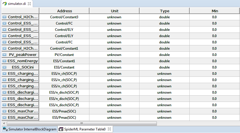

I have a table of parameters which is well generated from Popup menu > New Parameter Table (cf. the figure below)
index.php/fa/22421/0/
There's no prob with this table.

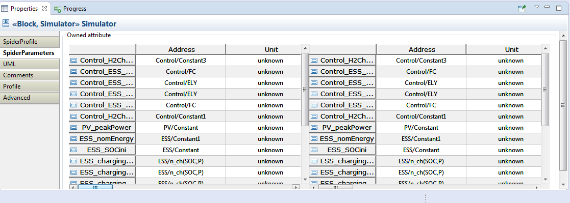

However, when I tried to put the papyrus table into a tab located in the Properties View. It showed two identical tables like this:
index.php/fa/22422/0/
Do you have any idea about this kind of problem?
Is this a bug to be raised?

I've reinstalled a new Eclipse Mars, and run all plugins and the problem disappear: only one table.
So maybe I have unselect some plugins that cause the bad effect.
The problem is that :
- you remove or add some plugins,
- there's no error when you launch your app
- but the changing may affect your GUI,
- and you couldn't figure out exactly where the bug is?
