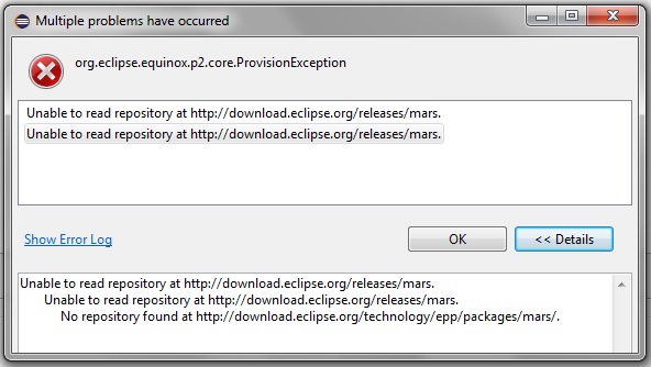

index.php/fa/22426/0/
Hello Eike,
I also installed "Eclipse Modeling Tools" 64 bit. and I don't have access to update site mars.
From my Error log:
org.eclipse.equinox.p2.core.ProvisionException: Unable to read repository at http://download.eclipse.org/releases/mars.
at org.eclipse.equinox.internal.p2.metadata.repository.CompositeMetadataRepository.addChild(CompositeMetadataRepository.java:185)
at org.eclipse.equinox.internal.p2.metadata.repository.CompositeMetadataRepository.<init>(CompositeMetadataRepository.java:106)
at org.eclipse.equinox.internal.p2.metadata.repository.CompositeMetadataRepositoryFactory.load(CompositeMetadataRepositoryFactory.java:122)
at org.eclipse.ui.progress.DeferredTreeContentManager$1.run(DeferredTreeContentManager.java:232)
Caused by: org.eclipse.equinox.p2.core.ProvisionException: No repository found at http://download.eclipse.org/technology/epp/packages/mars/.
at org.eclipse.equinox.internal.p2.repository.helpers.AbstractRepositoryManager.fail(AbstractRepositoryManager.java:395)
Notify me if you want all the stack trace.
Re: Eclipse Modeling Tools - no access to update site mars [message #1700948 is a reply to message #1700928] Wed, 08 July 2015 07:24 Go to previous messageGo to next message
Am 08.07.2015 um 13:05 schrieb David Rabely:
> Hello Eike,
> From my Error log:
> at org.eclipse.core.internal.jobs.Worker.run(Worker.java:55)
> at sun.reflect.NativeMethodAccessorImpl.invoke(Unknown Source)
> at sun.reflect.DelegatingMethodAccessorImpl.invoke(Unknown Source)
I'm not sure if it's related but for some users who used Mars milestone builds it helped to delete the
${user.home}/.eclipse/org.eclipse.oomph.p2/cache folder. Maybe you try that?
Cheers
/Eike
http://www.esc-net.de
Re: Eclipse Modeling Tools - no access to update site mars [message #1700965 is a reply to message #1700948] Wed, 08 July 2015 08:44 Go to previous message
It's ok with your solution.
I deleted the C:\Users\{Me}\.eclipse\org.eclipse.oomph.p2 folder
The update site is now reachable
Cheers Eike
David
